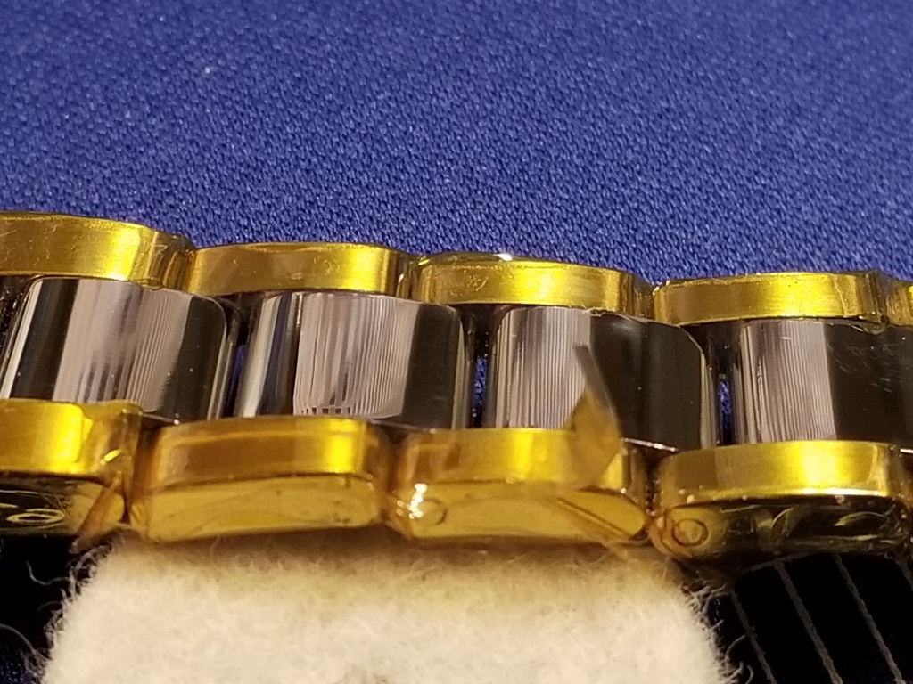

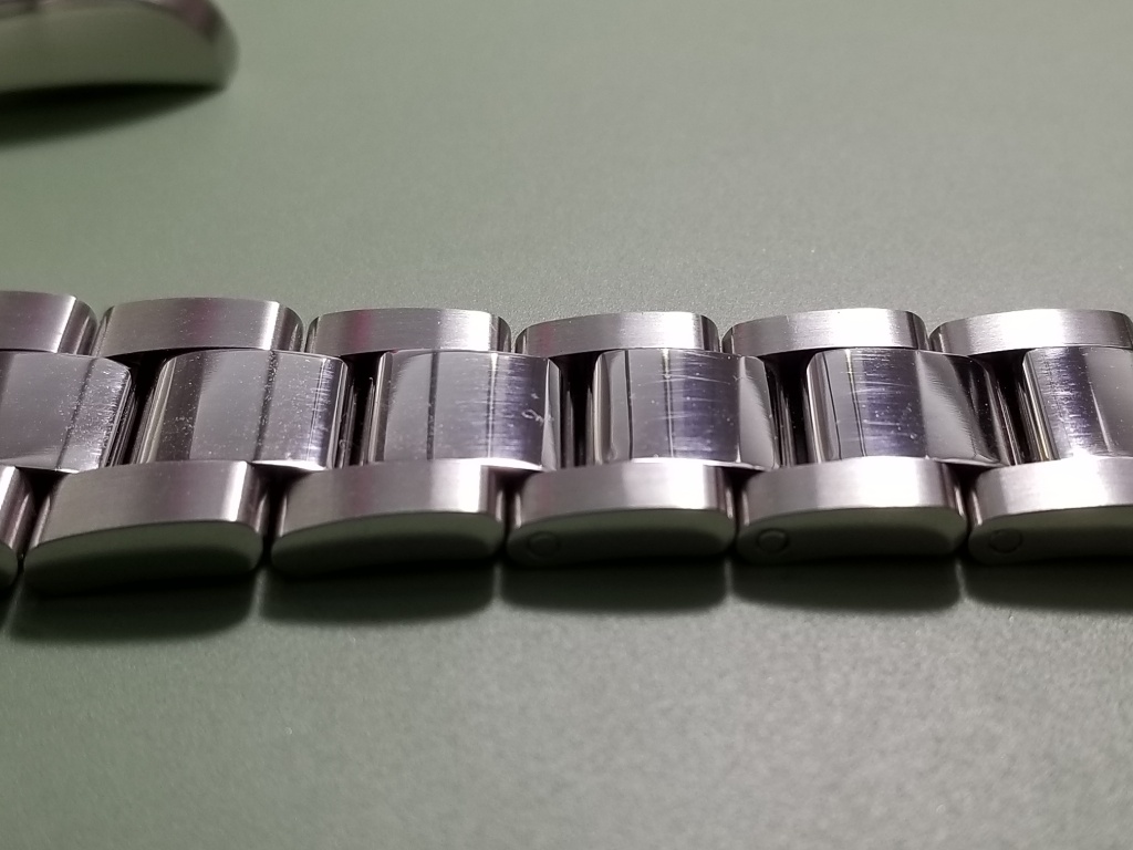

Is anyone using a Dremel rotary tool (brands don't matter) to buffing and polishing your watch case and bracelet? What kind of rotary head are you using for the mirror finishing? Wool, cotton or foam? And what kind of polishing compound are you using? Green or white?
I have a problem achieving the final mirror-like effect, always leave some very light lines on the SS bracelet surface. I use wool heads, green compound with 5000rpm but always comes back with some very light lines on it. Any idea what did I do wrong? Thank you in advance.

Cotton layer heads bro and Polinum is the magic bullet.

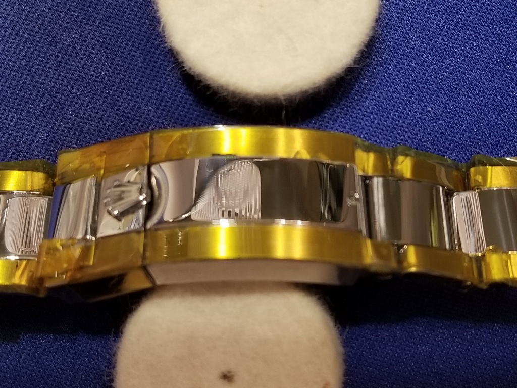

To get near perfect finishes, you need to use some sandpaper first. Depending on how scratched up it is, you can usually start around 1500 grit. Then, 2000 3000 5000 and I always end with 7000. Then straight to Polinum on the wheels - it's awesome.

Have you tried with the good old Cape Cod polishing cloth? It does work pretty well to remove those light scratches

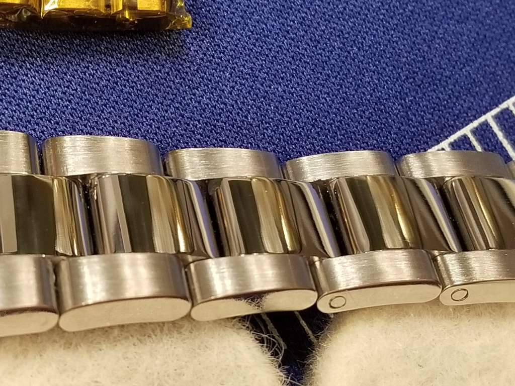

How do you get the brushed surface done? With sand paper, wheels or Scotch Brite like those who DIY?

I just ordered 2 packs. These only last a little while before getting clogged up. I used to wash them out and re-use them but they are so cheap I don't bother anymore. One wheel will do a whole case or bracelet but more than that the Polinum starts getting gritty and it will actually start to create tiny scratches. Just pay attention, you'll know when a change is needed.
Nah Cape Cod will help get you to the point of using Polinum but there's no comparison. Plus the dremel does the work and so much faster.

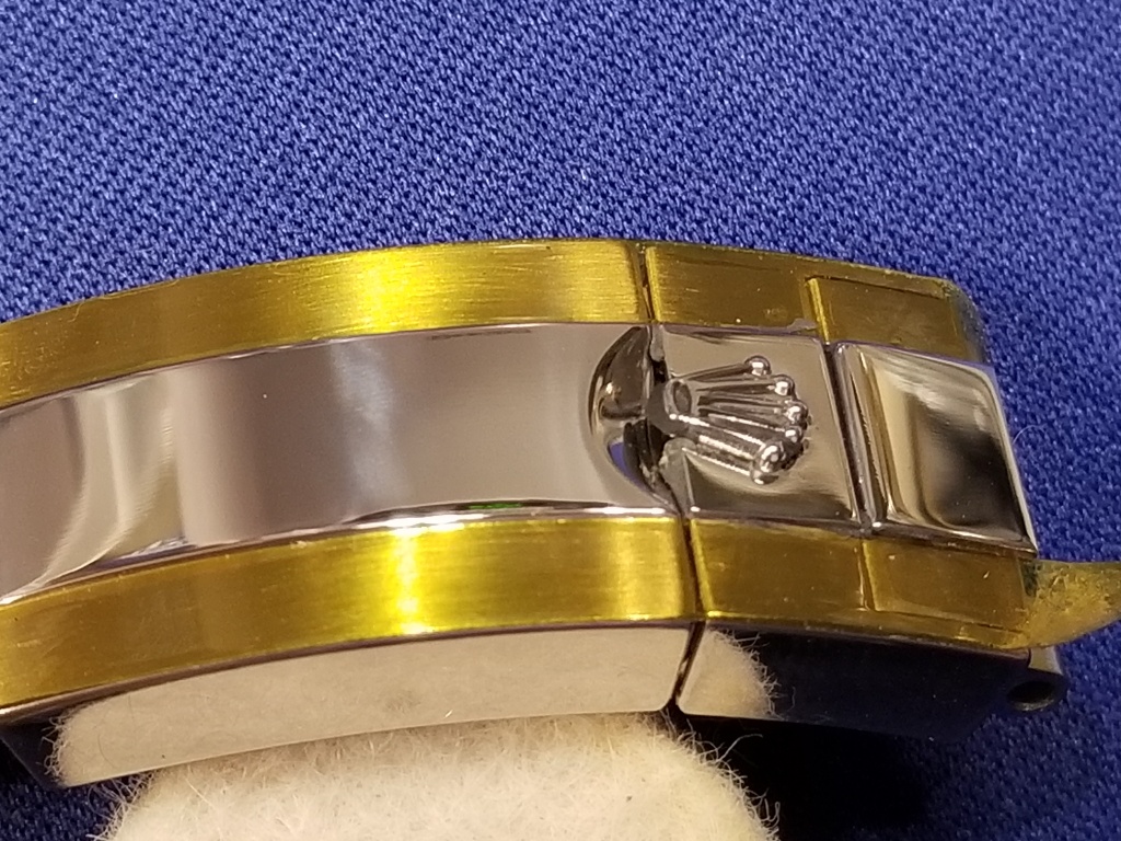

As said above, cotton wheels on dremel is the thing to do. I use as paste a metal polishing cream you can get from every hardwear store, it will get you a mirror like polishing.

It depends on how bad they are. I use Scotchbrite if it will take out the minor scratches. If not, sandpaper first. 600 grit first then up or down in grit as needed. Finish with Scotchbrite. Ofc tape up the center links, then you can brush freely. I've gotten to where I can do it evenly freehand. Another technique is to drag the bracelet across sandpaper flat on a bench.

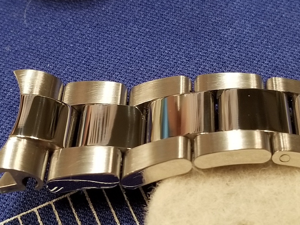

For mirror polishing I also use the lathe machine with cotton wheel and Bergeon white polish compound with good results.
However, to achieve the almost perfect mirror polish I get the best results by using Cape Cod mounted on a Dremel piece.
