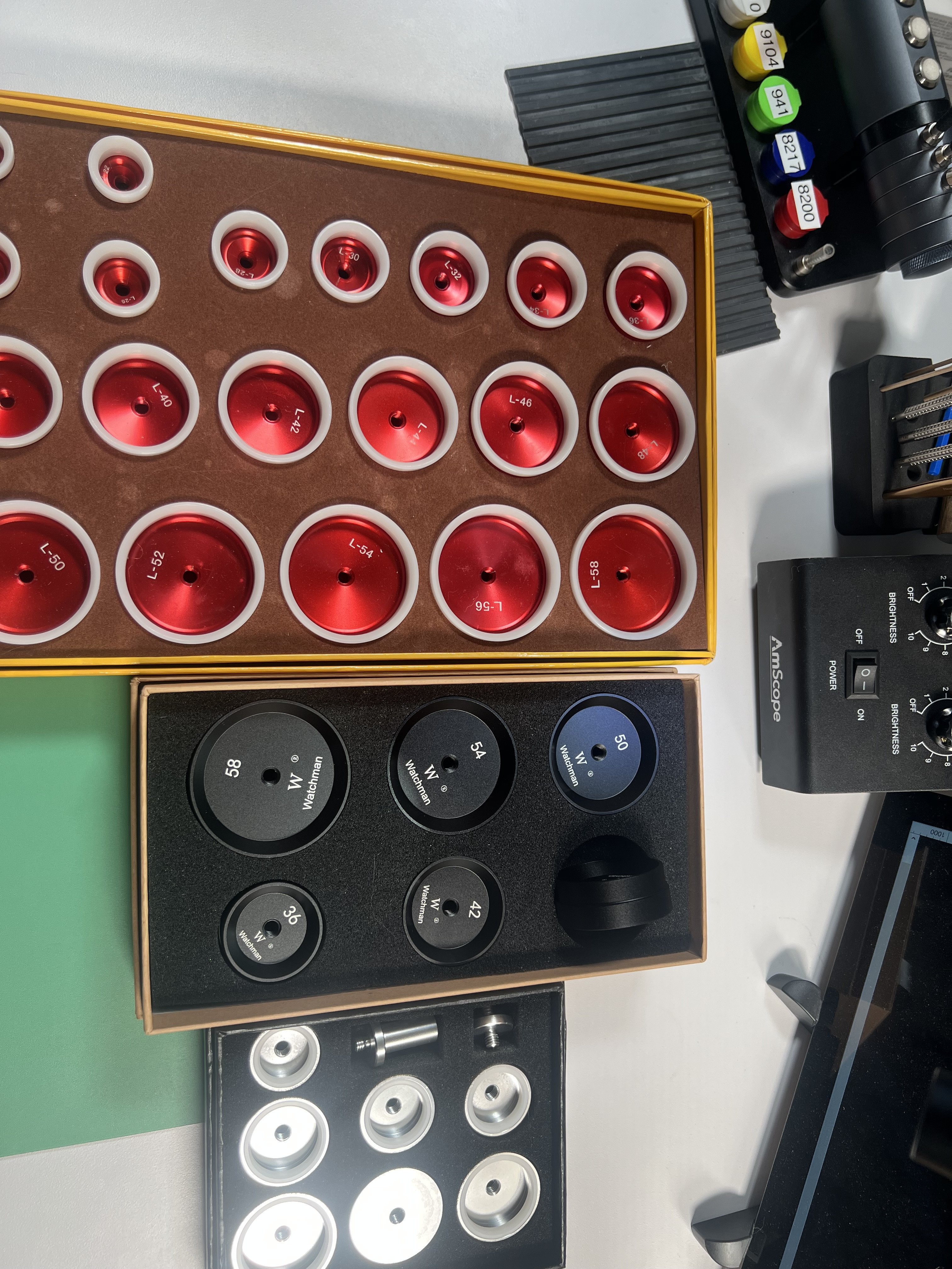

Red Deep Dish Dies -- $50
These are very good considering the quality. The outside edge is hard Delrin and the correct bevel for pressing those tension rings. I have zero complaints.
Watchman Dies (6 dies, 12 sizes) $30
(The middle box)
These double sided dies are excellent pressing sapphire and serving as a caseback (use a cloth or polyamide plastic to protect).
Far right - Needs a new home. Aluminum dies with delrin on outside edge ($23)
Ordered not paying attention and have 2 sets of these.
Note: If anyone out there has a need for some dies, they are free for the cost of shipping.
