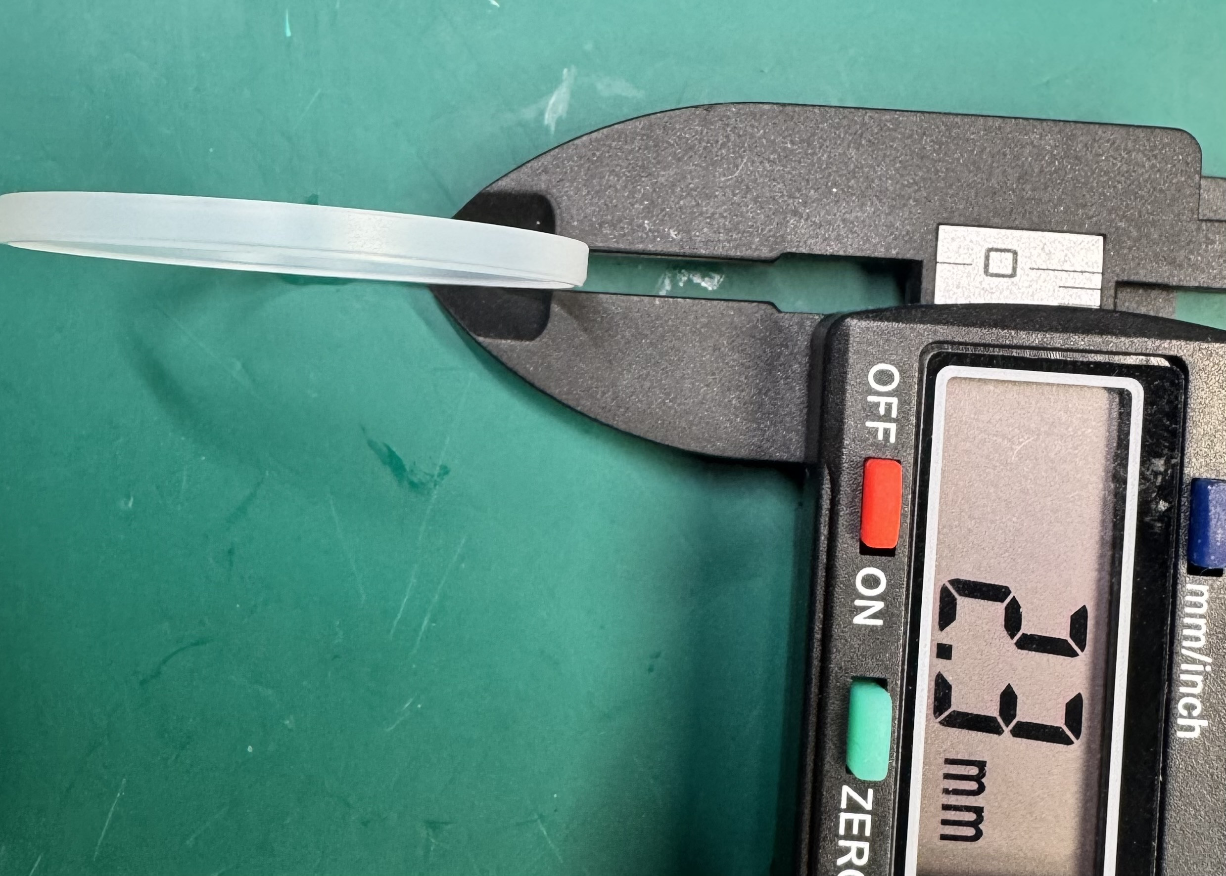

Thank you! Yes sorry, I must’ve not mentioned that this was VS only not VR, I love the modularity of the VS32xx platform.
The gasket used was 2.3mm.
I would strongly advise to just purchase a gen seconds wheel/swap it. trimming is too much of a hassle. Tolerances may vary from movement to movement as these are rep parts after all. The seconds wheel pinion will be slightly recessed below the minute wheel pinion if done correctly. When pressing on the second hand you won’t be able to see if you’re on the pinion or not you have to go by feel.

Wow 2.3mm gasket - this is great. So a gen or gen-spec (DD/VS) 3235 seconds hand wheel eliminates all guesswork on gasket height to get proper date mag, crystal sitting height, and second hand clearance. Boom!
It will be interesting to see if the same holds true for the SH/VR movements.

Haha yes! Perfect magnification achieved! I was surprised I hadn’t seen this done before. Shaving gaskets and messing with clearances is a pain in the ass. This is a one and done solution. I may finally get the chance to use all the spare VS parts I have laying around.

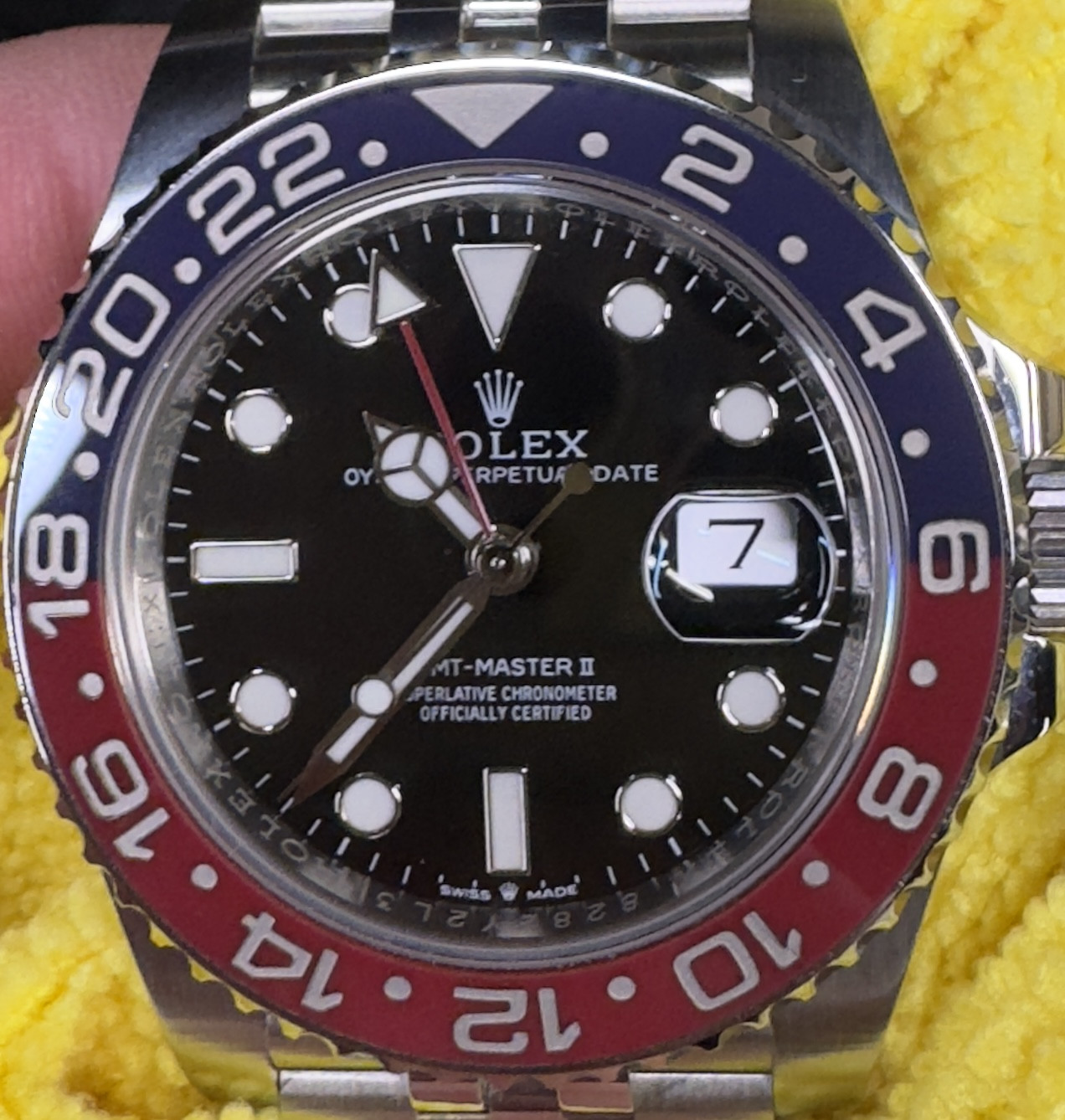

This better shows the Crystal height. Looks perfect to me!

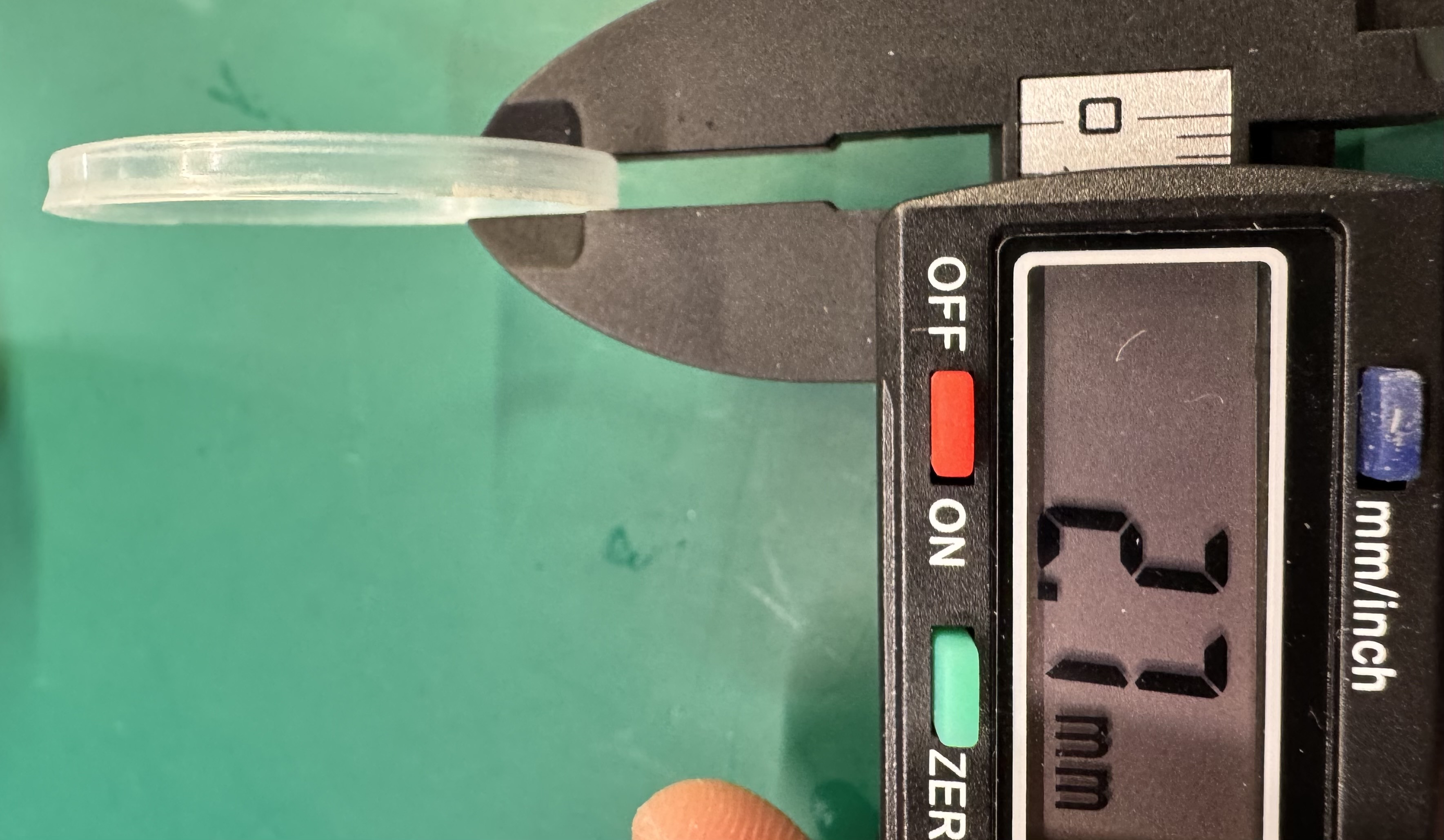

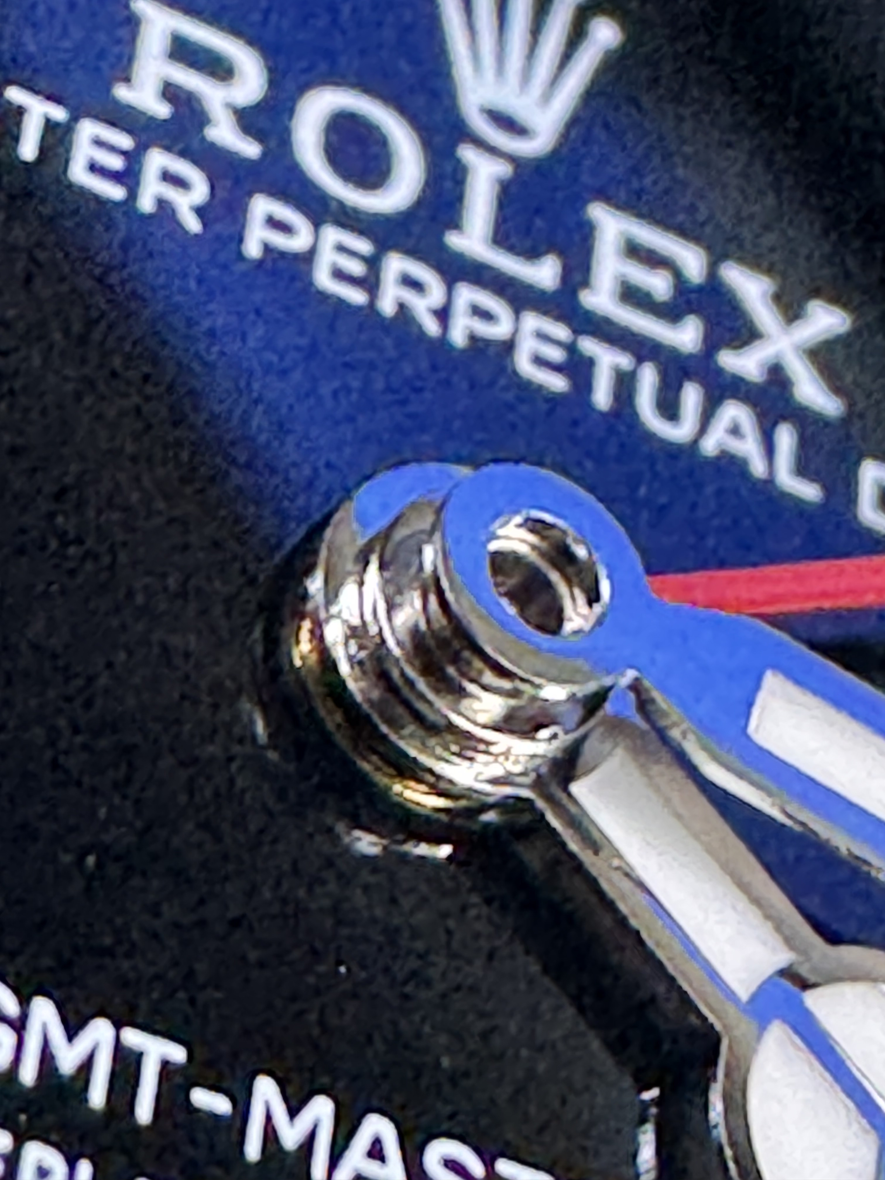

Returning to this thread as I’ve had the opportunity to do this a second time & capture better photos for you all.
Here is how the hand stack should look prior to installing the seconds hand.

Amazing work. What would you recommend the gasket height would be if I wanted to just swap the stock xtal to deep xtal. Heard that need to change gasket for better date mag. Of course disregarding the deep xtal sitting higher than the bezel unlike gen.
Spaceballer
6/8/24
100
156
United States
Deep is 1.8mm thick, give 2.8mm a go, you may get lucky with a 2.7mm
