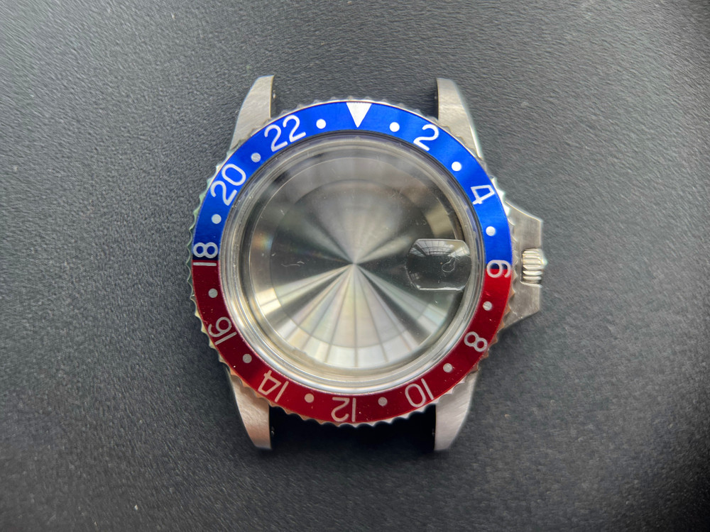

I'm planning to use a Raffles 1675 case, but the color of the bezel is too bright and I don't like it. I want to slightly tone down the bezel or make it a more natural color. What methods can I use?
(Can I bake it in the oven? I remember hearing about this method before..)

The Raffles bezel assembly is not great, and the insert is too thin. You may want to look at upgrading it to something like so (I believe this is the same one I bought from Clark some years back) and use a better insert:

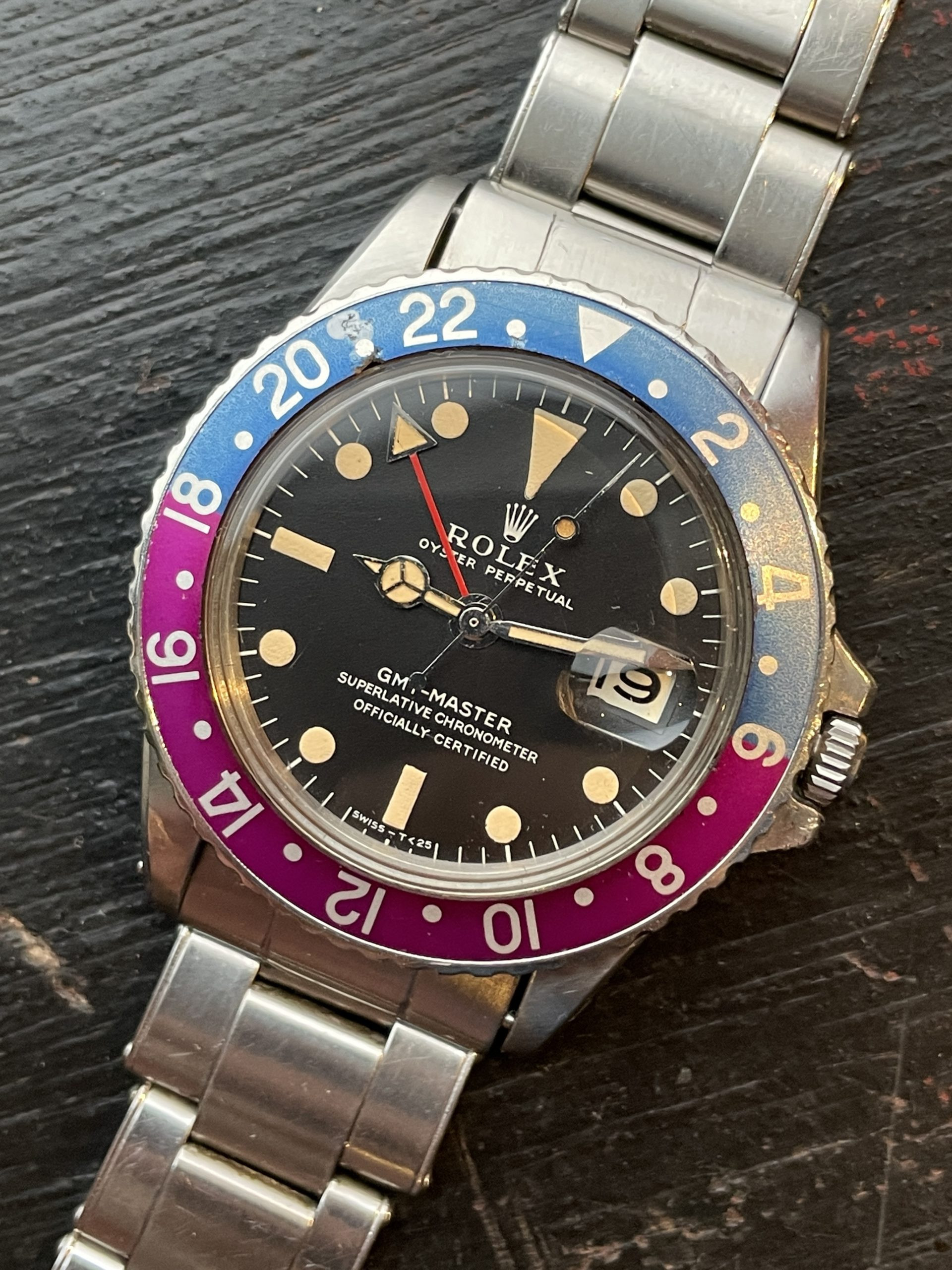

How are people getting that fuschia color on the 1675 bezel inserts? Is that through fading or are the inserts colored that way to begin with
I would also like to know. the best ive ever gotten was a dark fuschia
Yeah, the quality of the Raffles bezel doesn't seem to be great... At this rate, replacing parts might end up costing more than a factory replica😆
The inserts are absolutely colored that way. While it's possible I dream of watch parts in my sleep, I swear I saw a vintage pamphlet showing fuscia inserts available at your local service center.
It would be a first for me to dream of vintage advertising about watch parts, but I haven't been able to find that again!!... only find rumors of faulty anodizing between a short period in the late 60's? There's no way to make an aftermarket Pepsi turn fuscia without re-anodizing.
