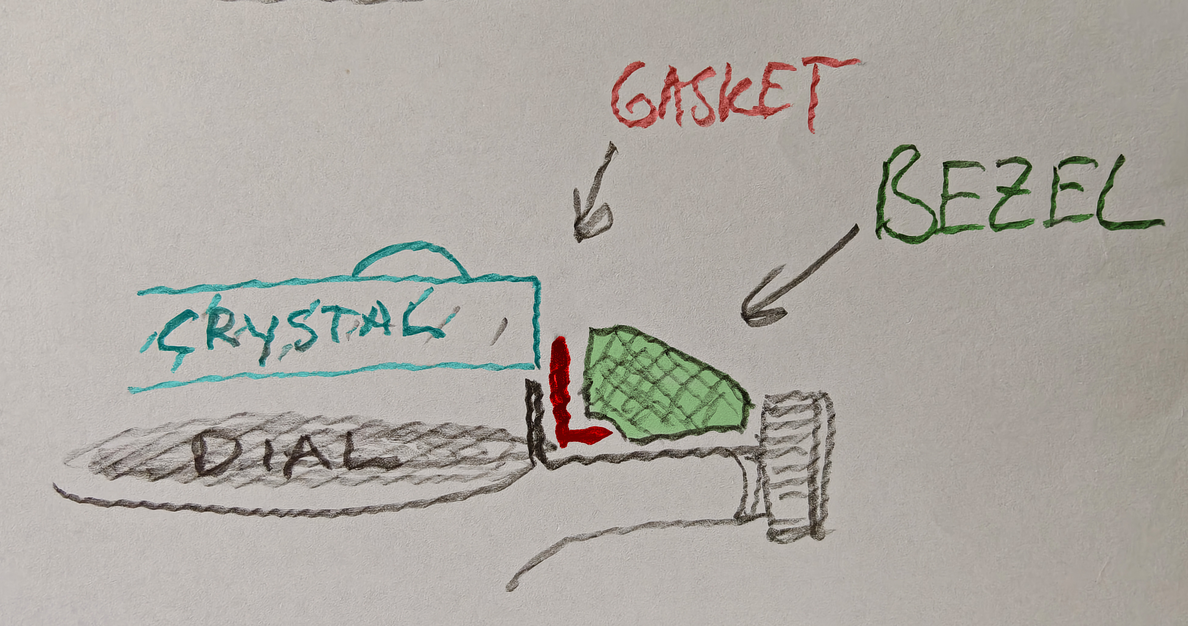

After replacing crystal I cant get the bezel to get al the way down again.
I've got this setup now, and I'm wandering if the gasket is put in wrong or did I miss something else...

I did it exactly like this guy (besides that I wear gloves). Maybe I just need to press a bit more fanatic

Are you using a die or pressing by hand? You need a die.
The second thing is that you need to check gasket height and such. Not every crystal works with stock gasket.

I use a die, I got the gen gasket with the gen crystal. Tried one the gen, maybe the original will fit!
Thanks for the tip
