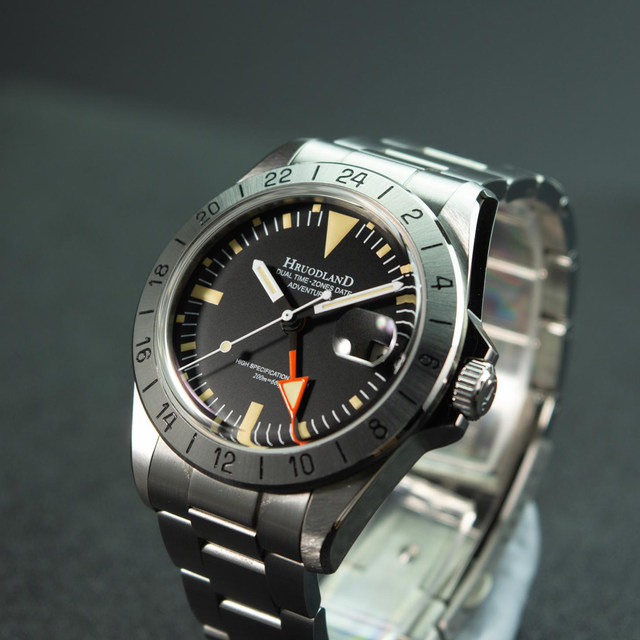

Here are the dials and hands I was looking at.

I would get the one with the crownguards. It’s actually not a bad place to start. When you do a Rolex dial, it will move that datewheel in slightly so hopefully you can fit a Rolex acrylic crystal on there from an old GMT master 1675 or something. You will need lug holes drilled through to make that vintage look. Either way it will be a fun project and that’s how you learn. Who cares if it’s not 100%. It’s a fun process. The only other option is to search for a vintage 1675 gmt master because it’s almost the same case And small crown size. Not sure if anyone really makes one or not. Go for it and post pics of how it turns out.

I still think you are better off with the BP cartel piece yes you have to shape the one lug down slightly but its alot easier than drilling fresh lug holes, dealing with date window alignment issues , dial size, alignment issues, etc.
You will also need to swap the bezel as the #4s are different on the gen vs bp IF you need a hand with the case work, reach out to me.
