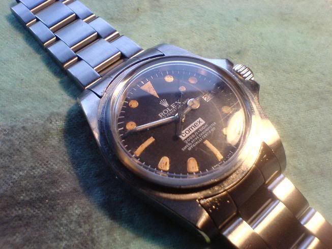

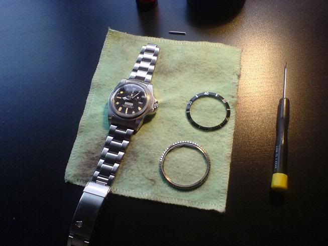

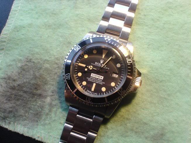

this is the watch

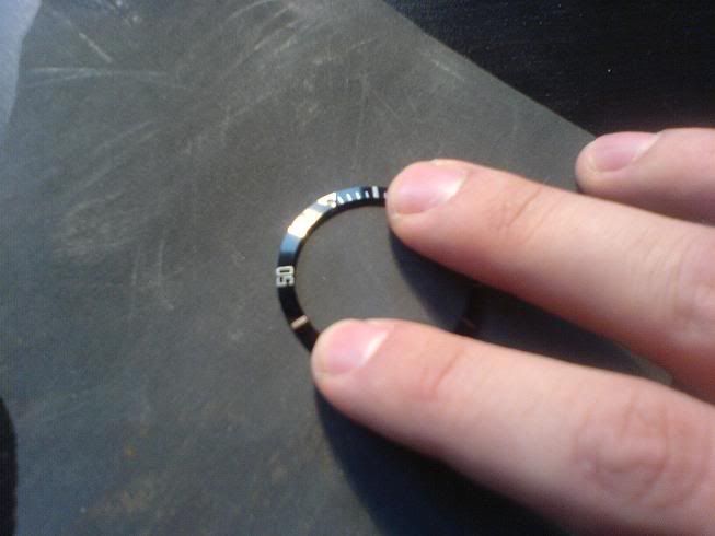

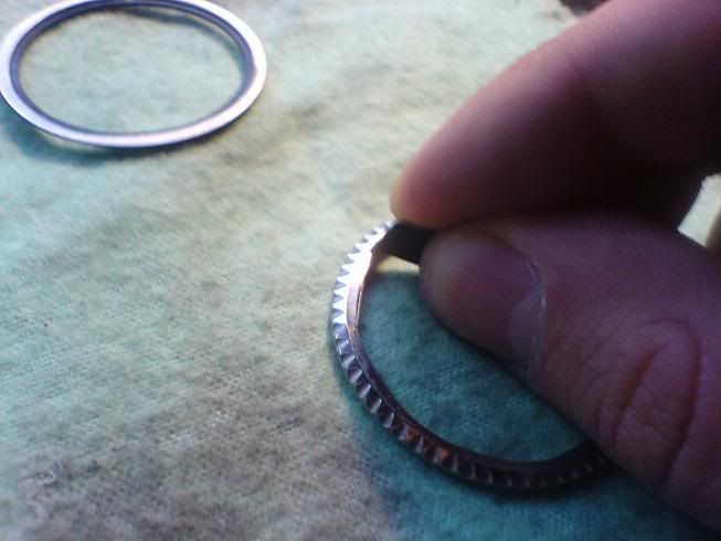

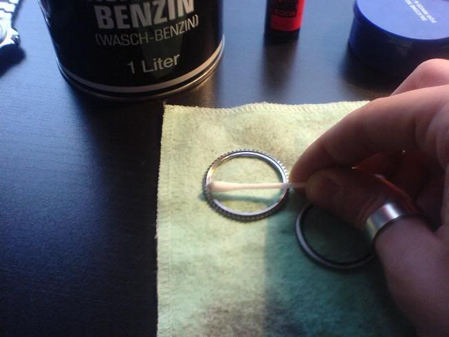

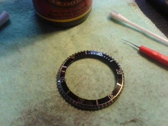

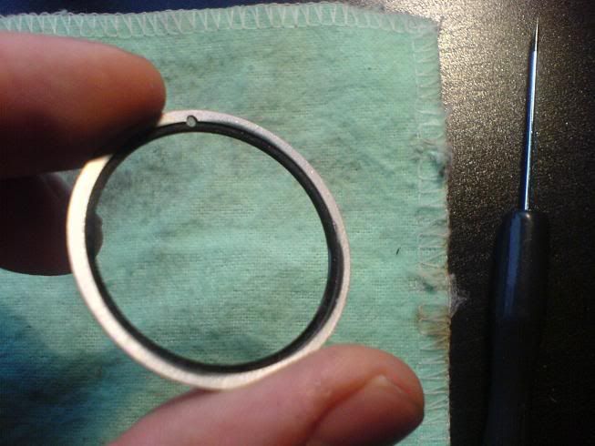

so first of all i removed the bezel and remove the old factory glue from the insert.

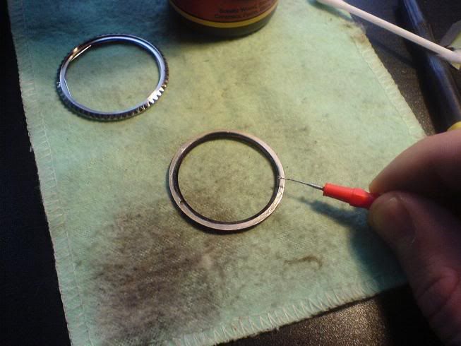

i used a sandpaper and grinded it down
did the same thing to the bezel

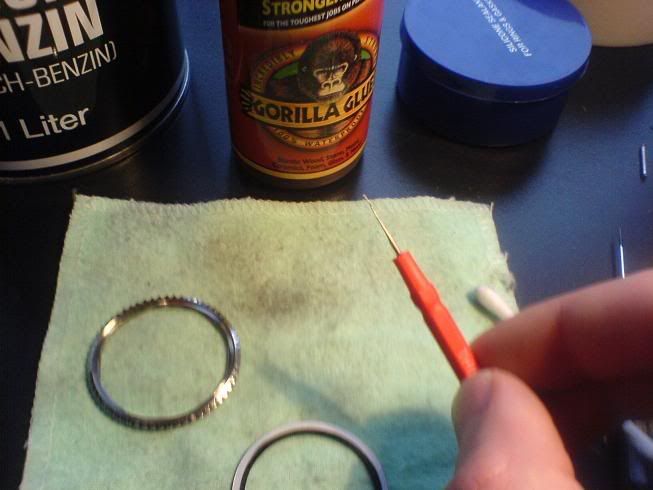

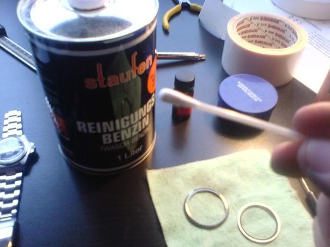

after that i cleaned both parts with cleaning solvent
then i gleued the insert in the bezel by using gorilla glue on an oiler
so its tight and ready to get mounted back

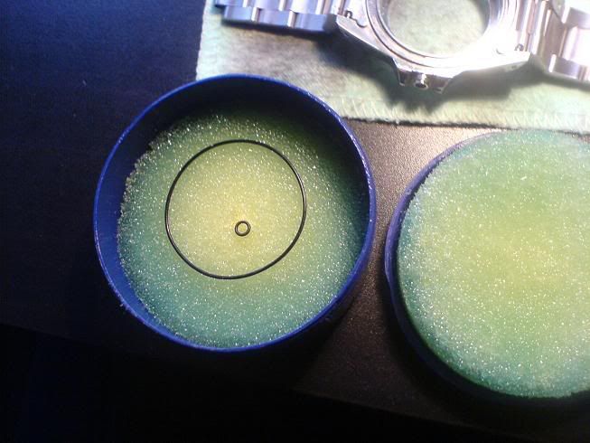

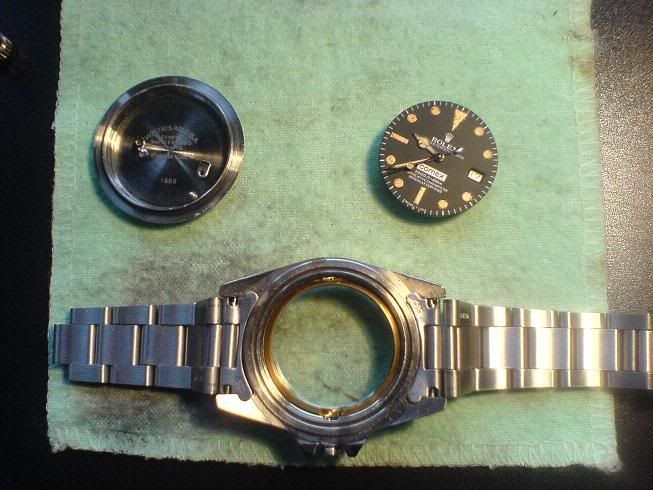

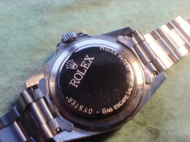

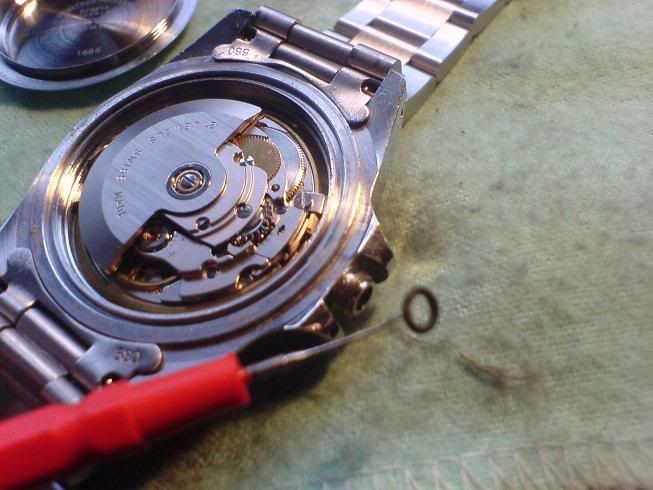

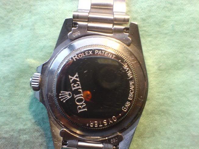

but before that i removed the caseback with my selfmade rolex opener
and removed all the sealings to grease them and make sure the watch will be waterproof
so this is the disassembled watch

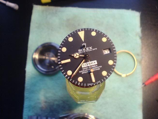

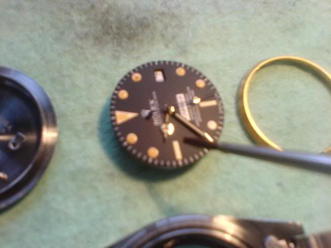

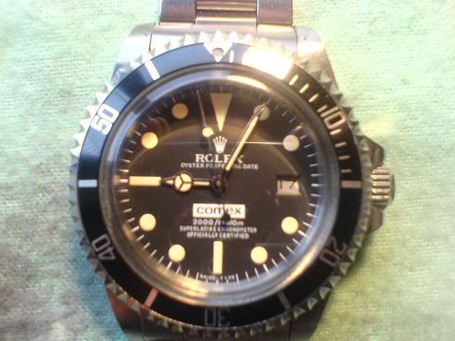

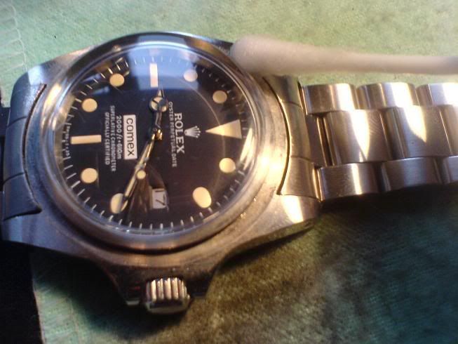

next i decided to give the lume a vintage look.
i wasnt sure how this could be done, but i remembered i read about laying a thin coat of coffee over the lume looks quite good
so i decided to give it a try
heres the first layer drying under a lamp
i did it twice and let it dry

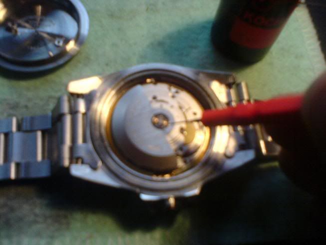

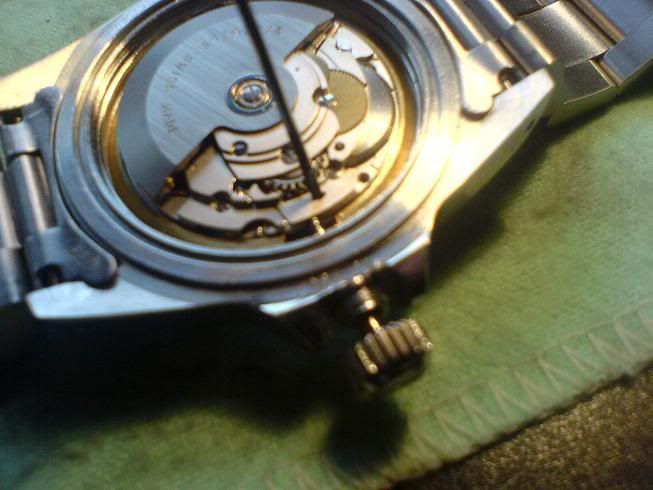

after that i putted the movement back in the case,

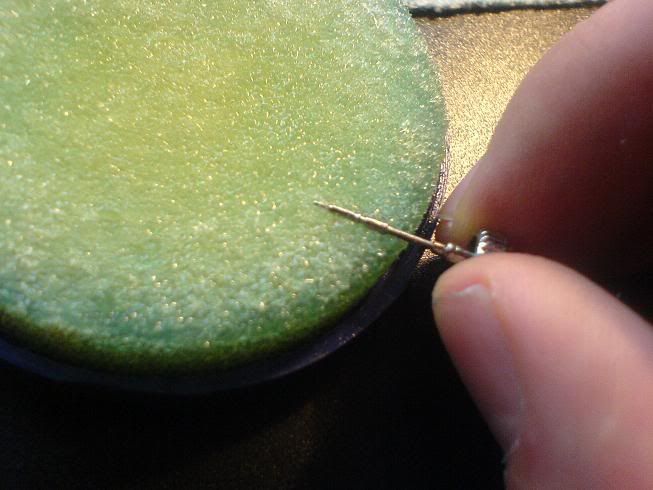

oiled the rotor,
and lubed the stem
then reassembled the o ring
and the caseback seal

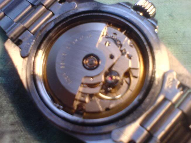

caseback mounted

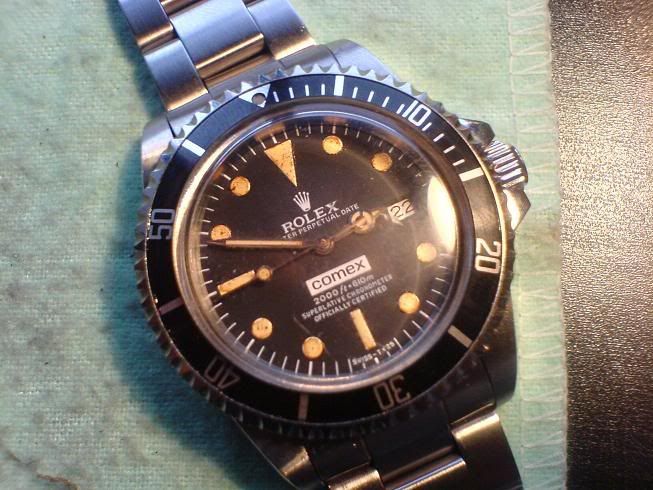

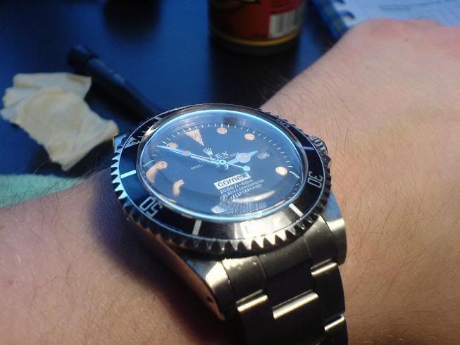

only the bezel is left..., but i already like the look of the lume
i know its not perfect but its fine for me :)
for comparison, this is how the lume looked before
heres a wristie :D
please tell me what you think about it

Excellent job Mike.. the case back is cool on that watch and looks like you have a nice Eta movement in there too..thanks for the pics. :D

wow mike im impressed. thats a great little write up!! I love what you did with your dial.
Please tell me... how 'thick' was your coffee mixture and how did you apply it? did you use a toothpick?
That lume looks awesome!! Very nice work
dizz
dizz
i used a very thin brush to apply it.
it was a mixture of an esspresso with old coffee out of an used coffee filter, sounds weird, but i though that would be the best.
in my mixture cup the coffee powder was sank to the ground, so i only got little crumbs of coffee on my brush and mainly the coffee.
im very happy with the result, but it could be a little more smooth.
i will try to figure out a better way to mix the coffee and put it on a cheapo submariner to see how it looks :wink:
