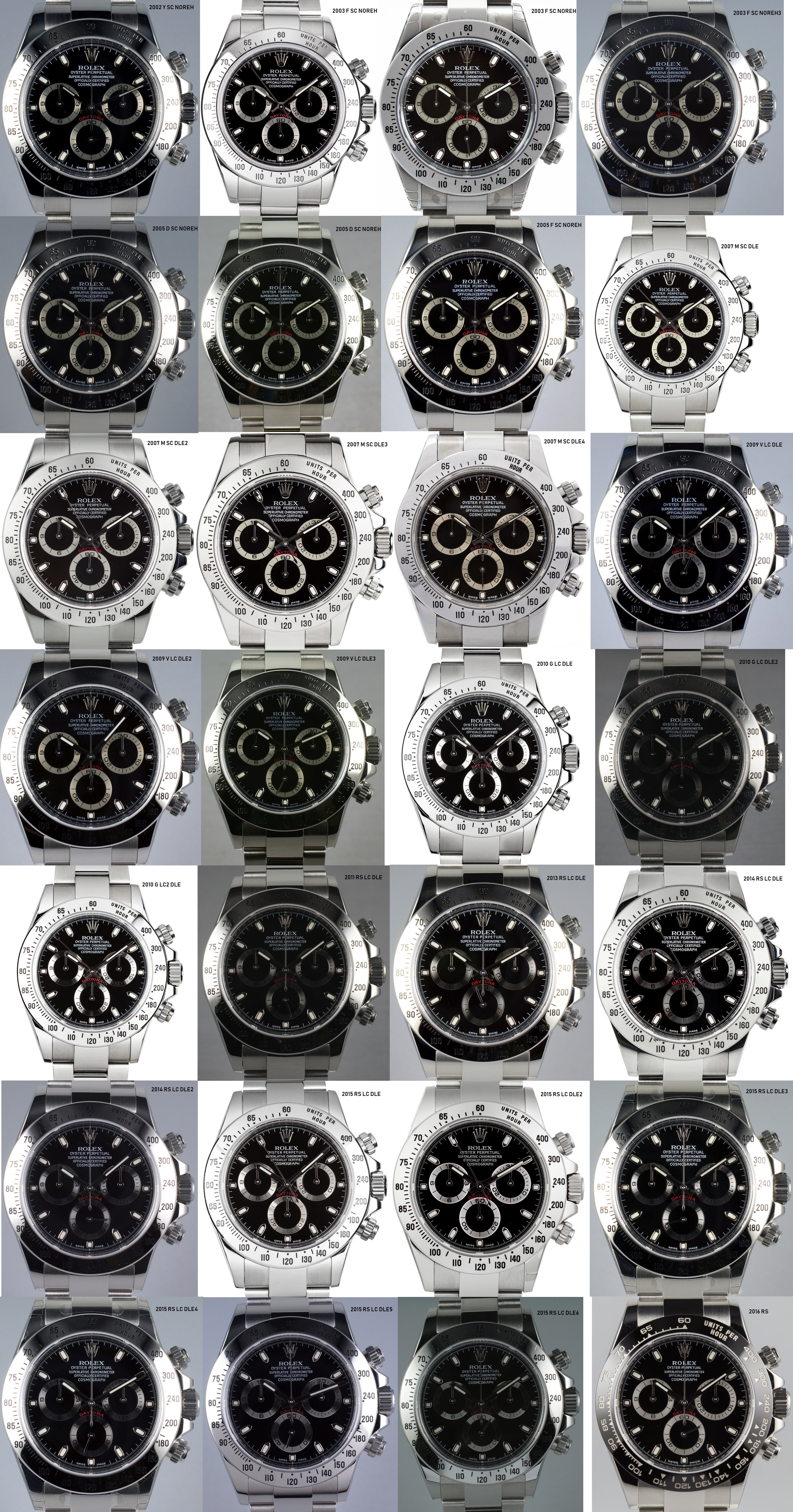

I'll first start with the black dials :

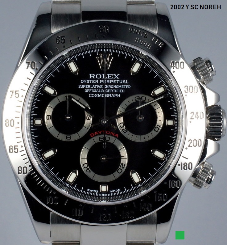

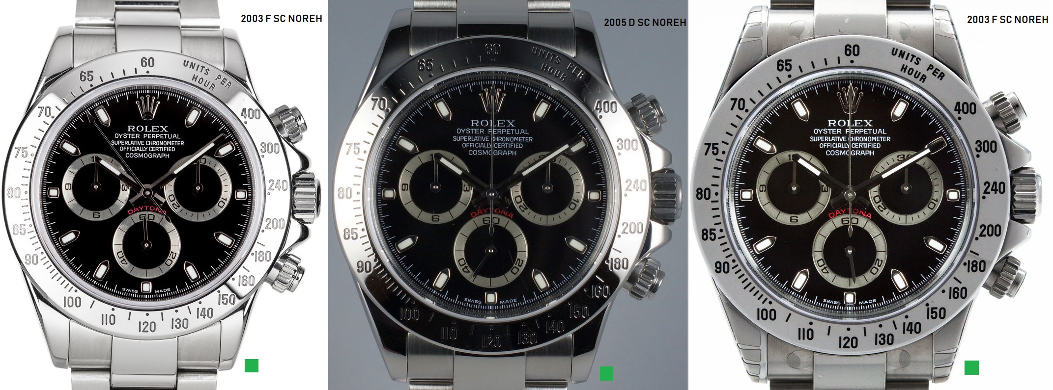

1. Flat 4 serif dials, most likely 2002 :
- The middle line of the E in ROLEX looks short and pretty much centered.
- the 4 in the 40 of the 6 o'clock seconds subdial is flat / upper part of the 4 is flat and wide
- 'O' in 'oyster' looks to be somewhere between 0(zero) and O
- 'swiss made' is serif
- The minute ticks under SWISS MADE almost touch the font. The 31 min tick hits the S bottom left while the 29th min tick sits in the center of the letter M
- 27 and 33 minute markers are long
2. Flat 4 dials, ~2003-2005 :
This 2nd category is part of a larger one which i'll call " the tall O" category. If you look carefully you'll see that the ‘O’ lettrs of the word chronometer are taller than the rest and look more like zeros.
- the 4 in the 40 of the seconds subdial is still flat / upper part of the 4 is flat and wide
- 'O' in 'oyster' looks to be somewhere between 0 (zero) and O
- 'swiss made' is not serif any more
- The minute ticks under SWISS MADE are a bit shorter than before. The 31 min tick sits a bit more to the right of the last S while the 29th min tick sits in the center of the letter M like before
3. I'll call this one the` Higher E` or `Upper E` , 2003-2005 :
This one is also part of the ‘tall O’ category. ROLEX font looks similar to the previous group but there is one key difference:
- 4 in the 40 of the sec subdial is not as flat as before / top part is narrower than on the flat 4 dials
Remaining aspects of this group:
- The middle line of the E in ROLEX sits just above the midpoint of the letter like on the previous group but the previous gruop had a flat 4 ! keep this in mind.
- The minute ticks under SWISS MADE look the same as on the flat 4 dials. The 31 min tick sits a bit more to the right of the last S while the 29th min tick sits in the center of the letter M.
4. Lower E 2007-2009 :
This one is also part of the ‘tall O’ category but here is what makes this unique :
- The middle line of the E is just below the letter's midpoint
- 27 and 33 minute markers are short now
-31 min tick sits almost where the last S of the swiss ends. The 29th min tick sists almost under the M starts.

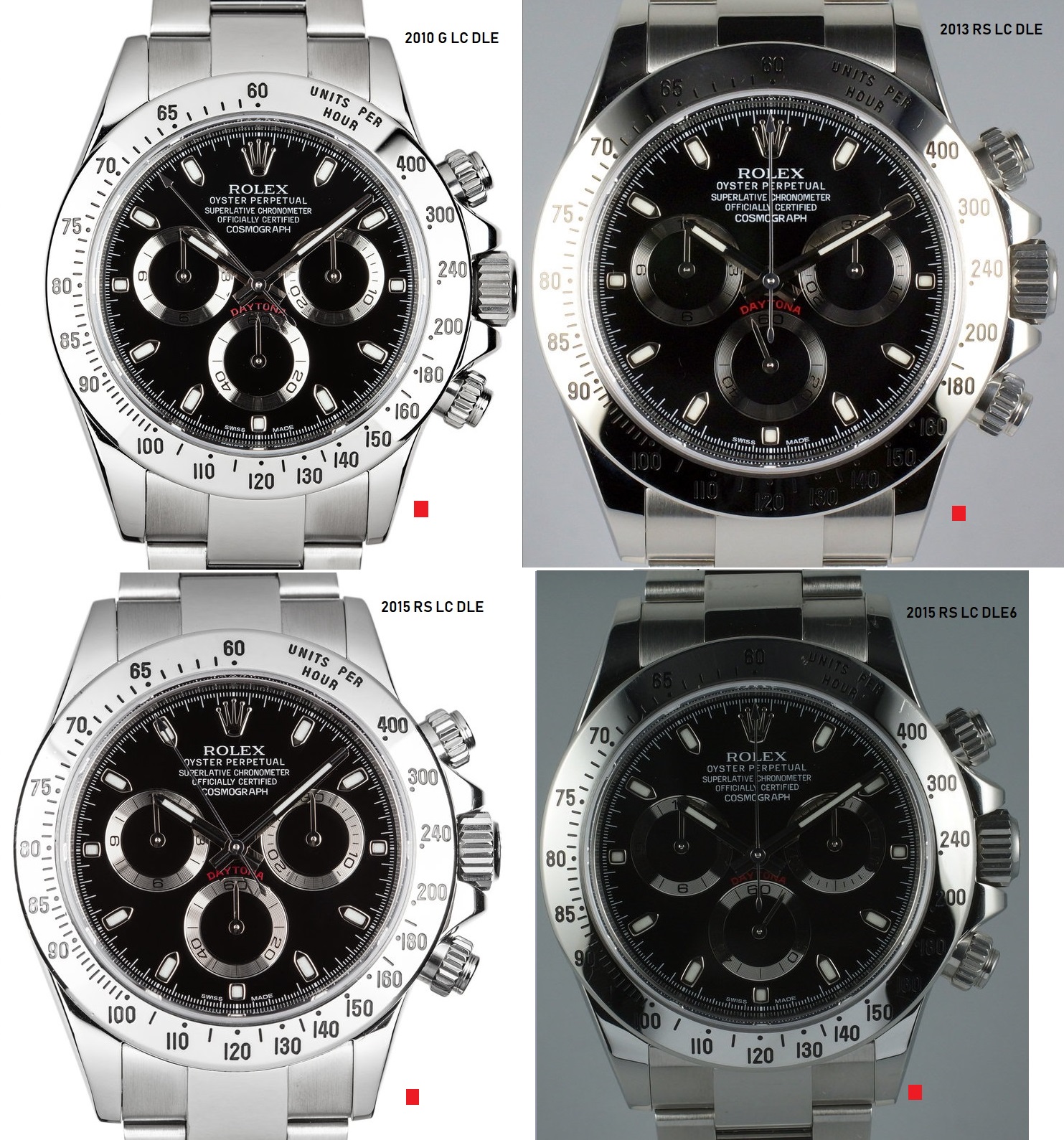

6. FAT 'O' dials ~2010-2015:
This is a new category of prints found only on the black dials. I'll call this the 'FAT O' dials because of the fat O of the oyster word
- 'O' is "OYSTER' looks fat / rounded
- Middle line of the E sists above the midpoint of the letter but this aspect is not as helpfull as before in differentiating dials.
- 27 and 33 min markers are long
- Rolex coronet has a bigger hole / more rouned as well
- another key feature is that all the dial print in white is serif!
- 31 min tick sits almost below the center of the last S in Swiss. 29th min tick sits almost where the M begins. This feature is again not that important.

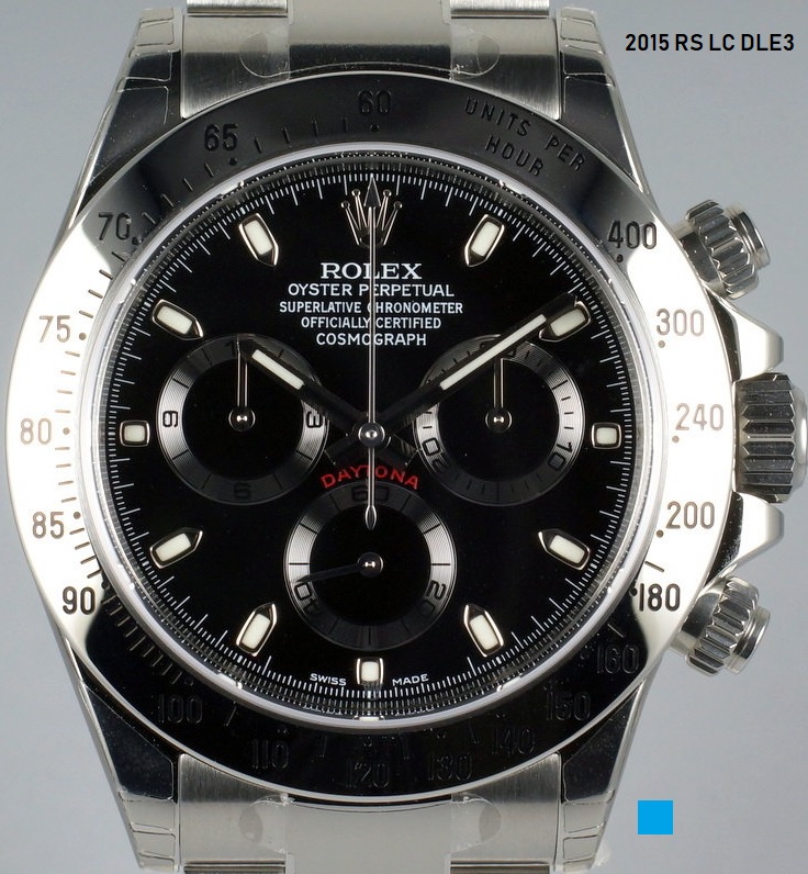

7. FAT 'O' short ticks ~2015 :
This is almost the same as the 'FAT O' dial but with some differences :
- same as the regular fat 'O' dials but the 27 and 33 min markers are short this time
- text doesn't look serif this time
- same coronet as before
- 31 min tick sits almost below the center onf the last S in Swiss. 29th min tick sits almost where the M begins. Same asa before.

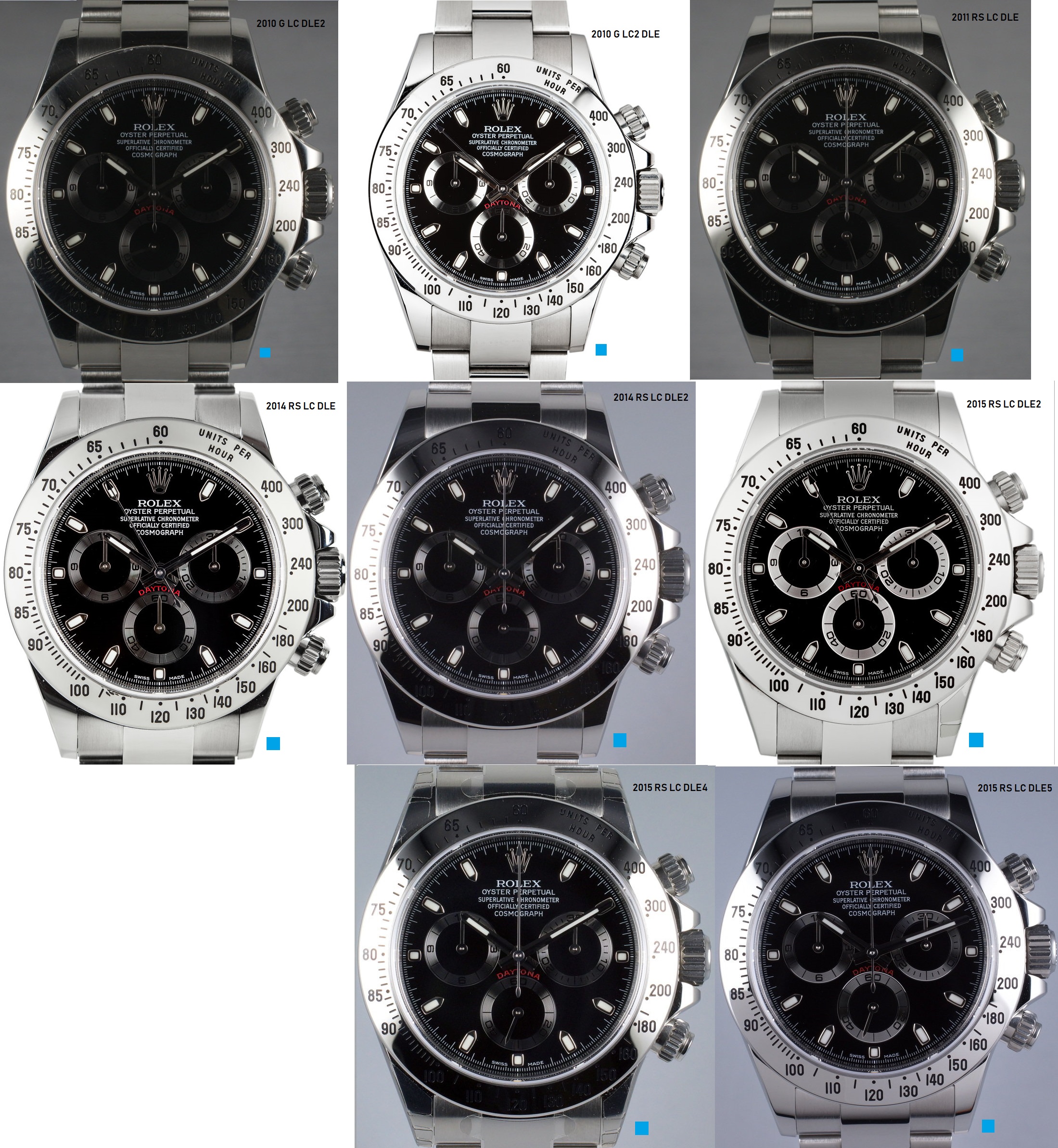

8.APH dials ~2010-2015 :
This is a whole new category. The main characteristic is that the APH letters of the COSMOGRAPH sit a bit separated from the rest of the letters. Here are a few details:
- APH letters of the 'cosmograph' word are a bit separated from the rest of the word
- 'O' in 'Oyster' looks more like a zero this time
- More tracking on the OYSTER PERPETUAL / spaces between letters are bigger
- I won’t bother to list the remaining characteristics as these are not as relevant imo.

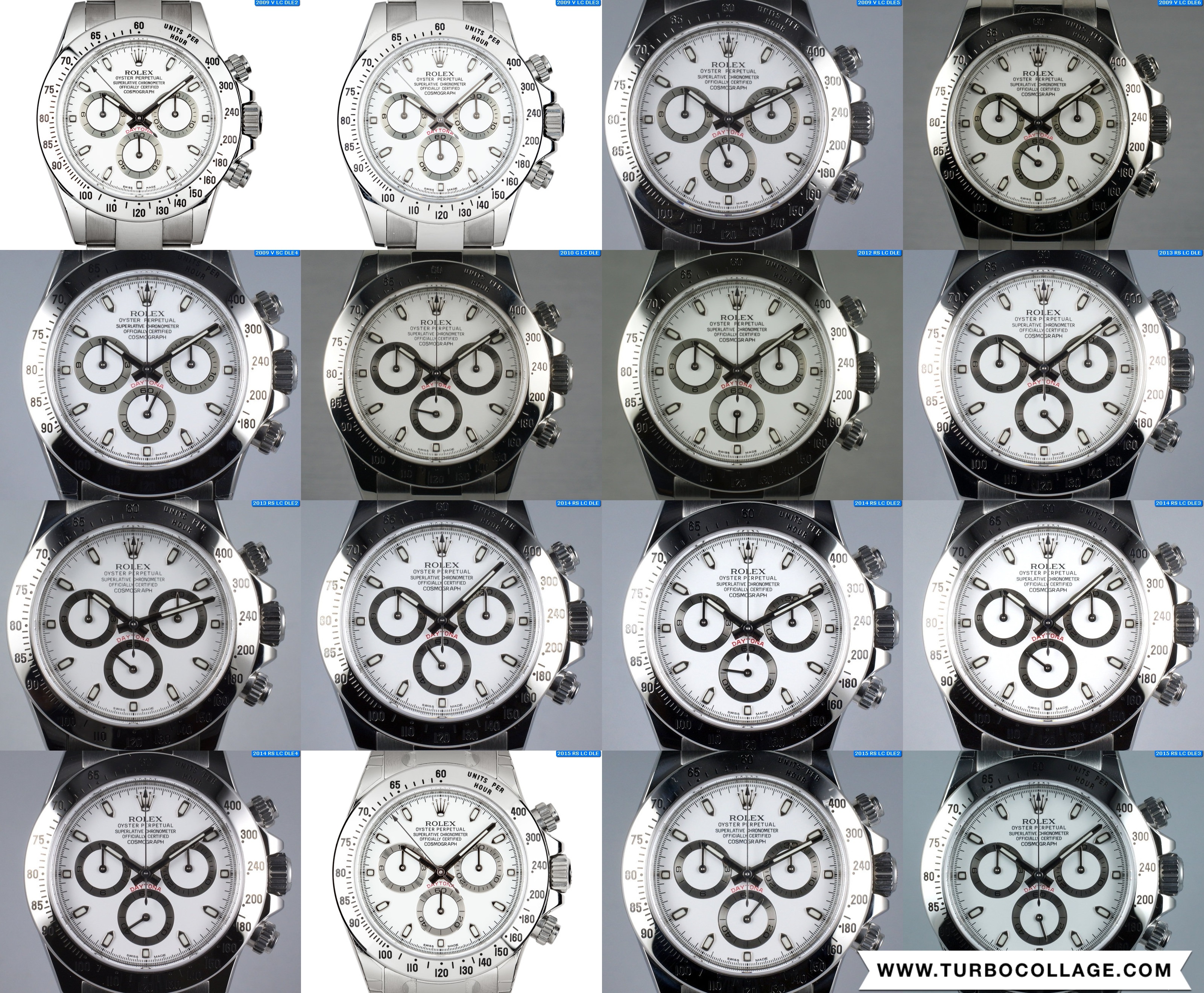

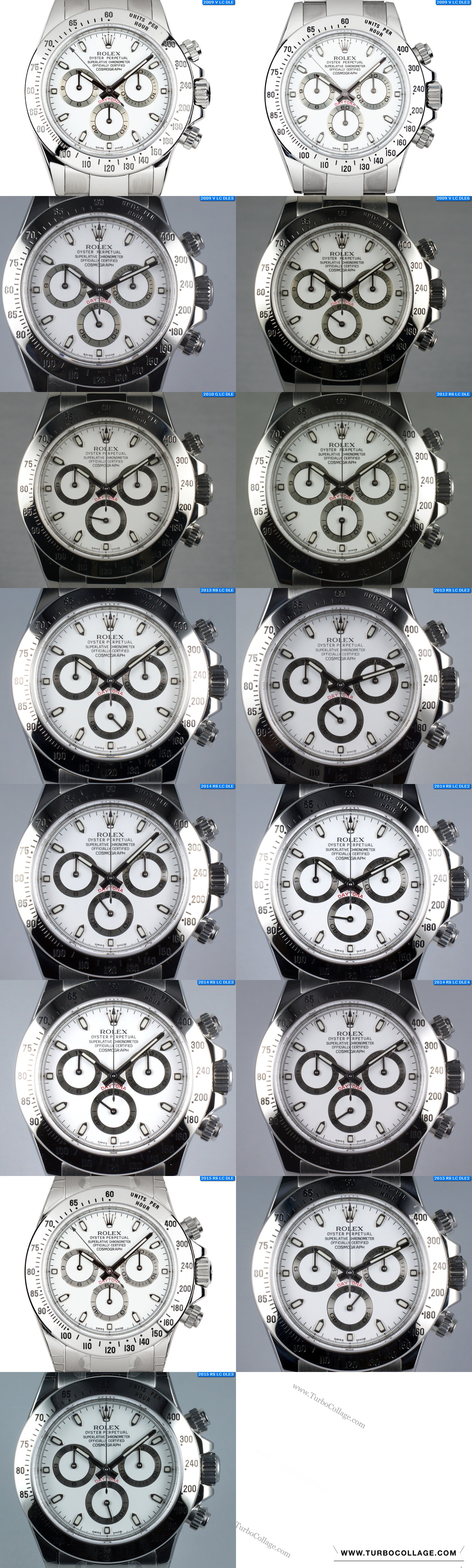

Ok ,so with the black dials pretty much covered, let’s move on and study the white dials :
Here are the dials again. Same pic as above but split in 2. Easier to handle on mobile devices :

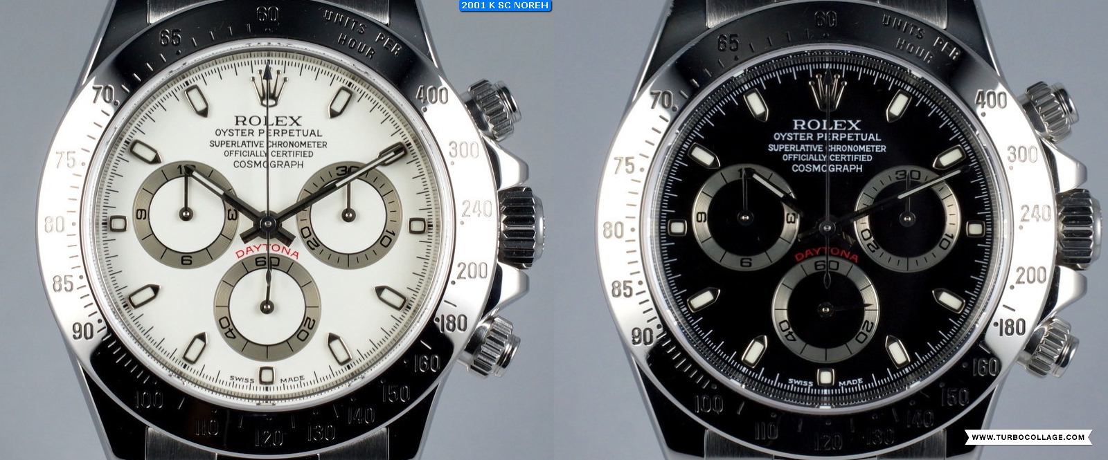

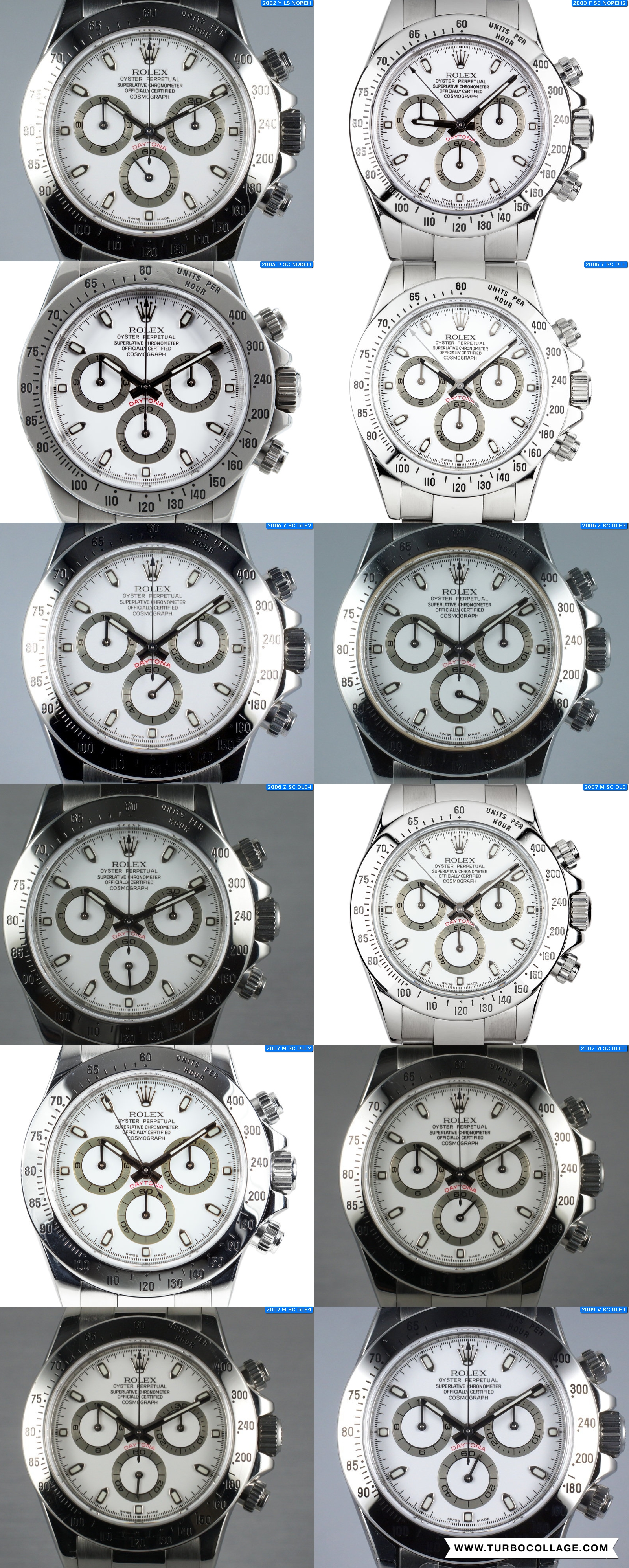

1.Flat 4 serif dials ~2001-2005 (edit) :
EDIT2 : initially i've thought this dial was produced till 2003, but i've found a 2005 D model with the same dial.
I have also found 2 other 2006 daytonas with the same dial but these watches might as well be 2005 .
Although I’m not 100% sure ,It seems that the 1st 116520 daytona to come out was the white dial version.
This dial is pretty much similar to the black counterpart, having a similar print layout:
- The middle line of the E in ROLEX looks short and centered.
- 'O' in 'oyster' looks to be somewhere between 0 and O

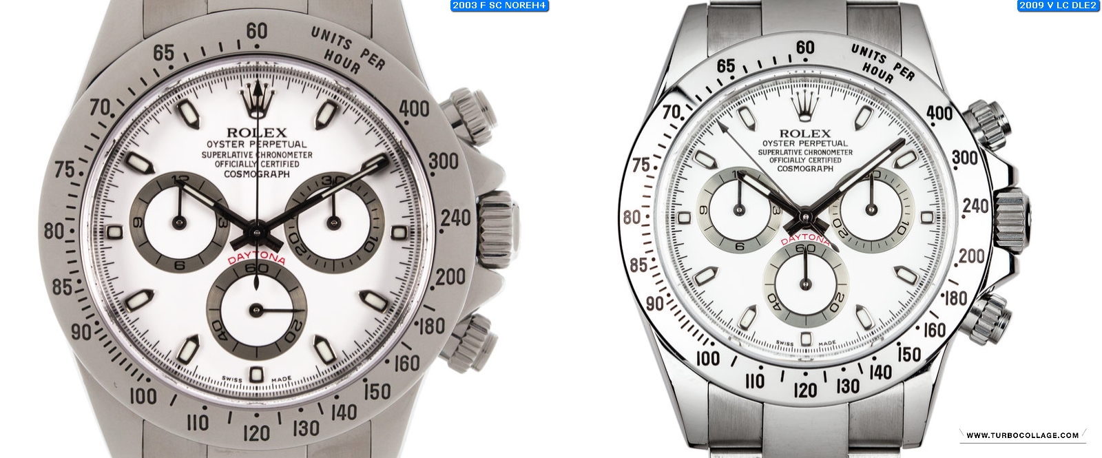

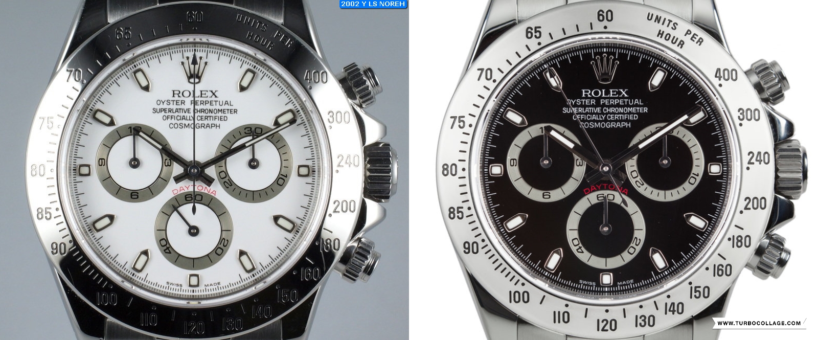

And here is a comparison picture between the white and the black flat 4 dial :

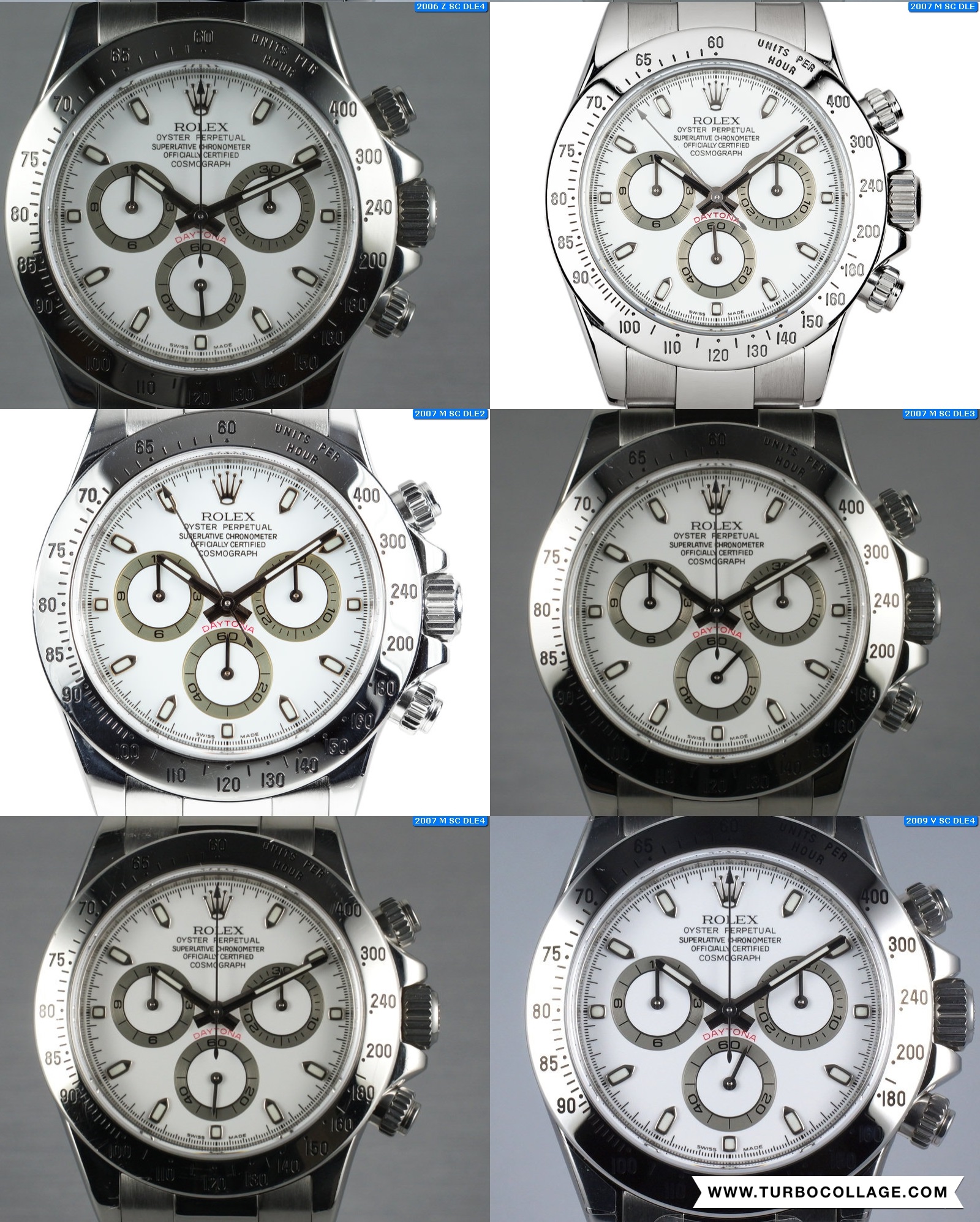

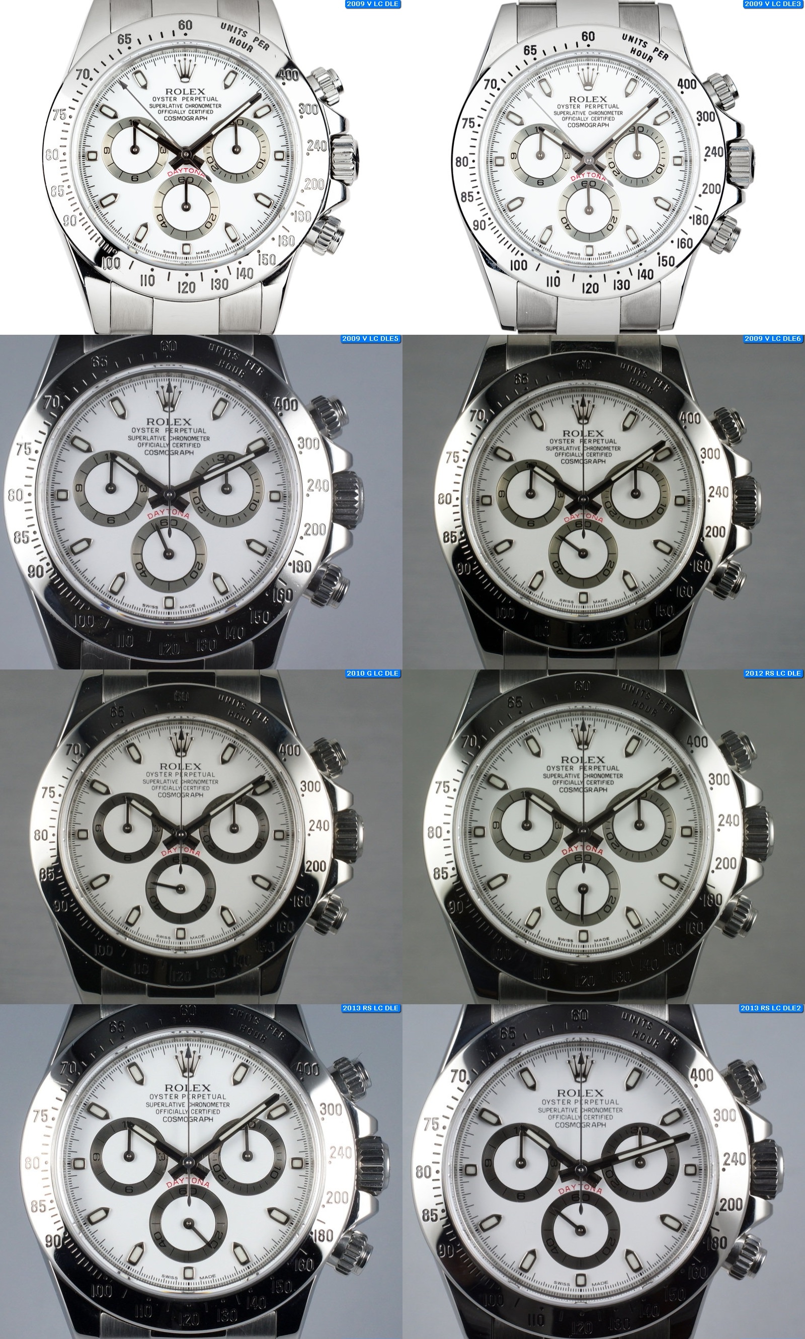

2.Lower E dials ~2002-2009 ( edit : most often seen on 2007,2008 and 2009 daytonas ):
These dials fall into the ‘Tall O’ category same as the flat4, higher E and lower E black dials.
I’ll keep the name ‘ Lower E’ just because this dial is the same as the black ‘lower E’ one but this name is not as relevant as before because there are no variations of the Tall O category for the white dials like there was with the black dials before.
So a more suitable name for this dial should have been “Tall O’ .
As I said before, if you take a closer look you’ll see that the Chronograph word has the lettrs “O” taller than the rest and looking more like a zero .
Key features are similar to the black one :
- 27 and 33 minute markers are short.
Here is the above pic again split in 2 :
Lower E comparison picture :

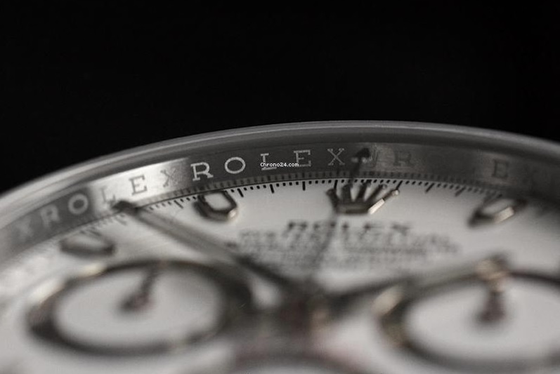

3.Serif Cosmograph dials( EDIT ) 2003-2011 :
EDIT : I initially though this dial was found only on daytonas made up till 2009 but i later found several others from 2010, 2011 using the same dial.
I've also managed to find this dial on some 2012 and 2013 watches, but i can't really be sure these ones were indeed manufactured in those particular years (many chrono sellers offer missleading details about their watches.
One thing's sure, on these 2012-2013 watches the clasp was new style ,serial was random and the SEL was one piece, but so are the vast majority of the 2011 models .
This print is not present on the black dials! Oddly enaugh I’ve found it on both a 2003 and a 2009 (edit : and 2010,2011 and 2012) watch, so this dial makes identifying a watch’s manufacturing year pretty hard.

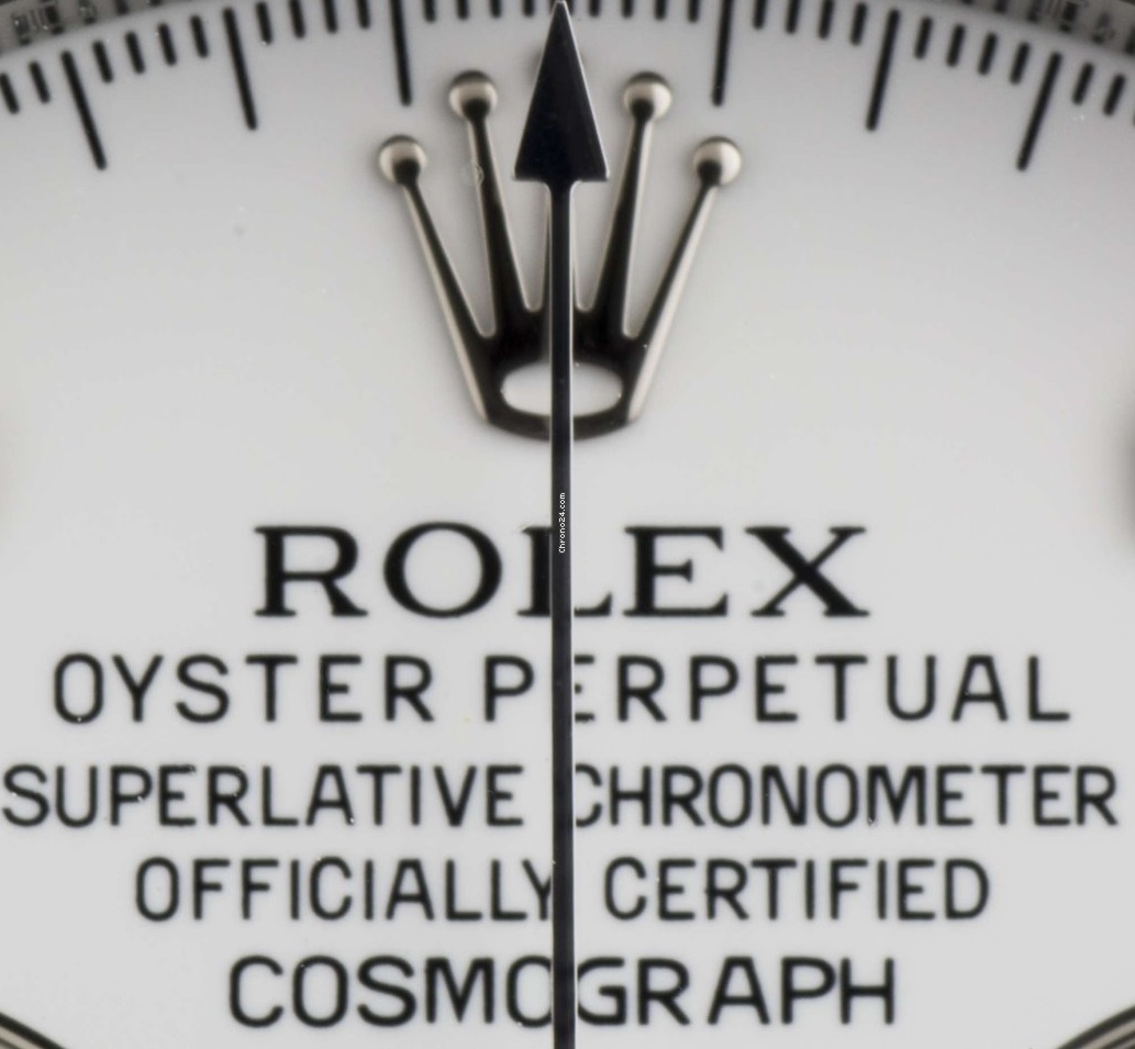

The main feature distinguishing this dial apart from the rest is the serif ‘COSMOGRAPH’ . The fat O black dial featured a serifi COSMOGRAPH as well but, so was the rest of the text. This white dial on the other hand has a very pronuanced serif look ( the cosmograph word ) while the rest of the text looks more normal if you will .
Some other characteristics of this dial :
- ROLEX seems to be a bit bolder than on the other white dials
- 27 and 33 min ticks are short
- 31 min tick sits below the end of the S in SWISS while the 29th min tick sits below just before the M in MADE starts.
- I won’t bother pointing other aspects as the ones above are pretty much sufficient to define this category

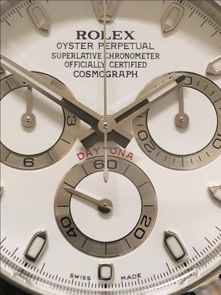

Serif cosmo dial close-up :

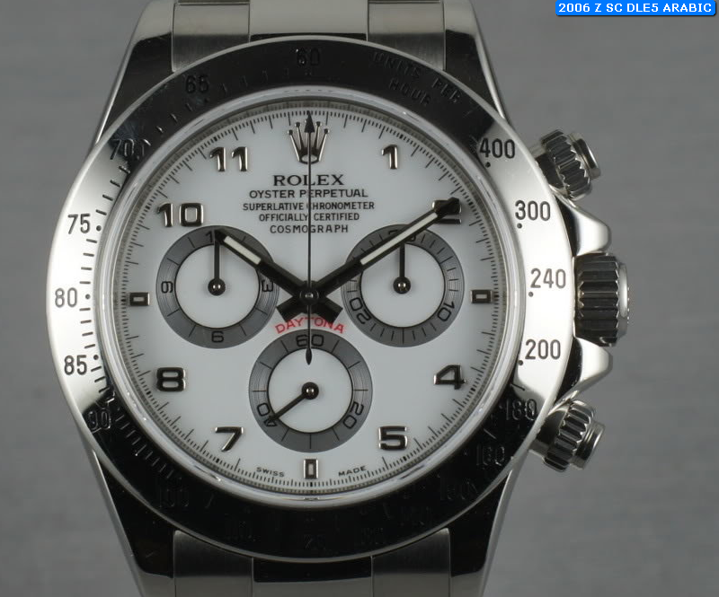

4.Arabic dial ~2006 :
As far as I know there wasn’t any stainless steel black daytona out there to feature an arabic dial, so this is a category on it’s own. Please keep in mind that there are some other arabic dials out there but found on the WG and platinum versions.
Although it’s obvious how one is able to differentiate this dial apart from all the other white dials I’ll point out some details of the print and layout:
- At a first glance the print looks similar to the “Fat O” print found on the black dial .
- SWISS and MADE however sits further apart from the 6 o’clock marker and the text looks wider as well.
- COSMOGRAPH is serif
Here is a pic comparing this to the Fat O black dial :

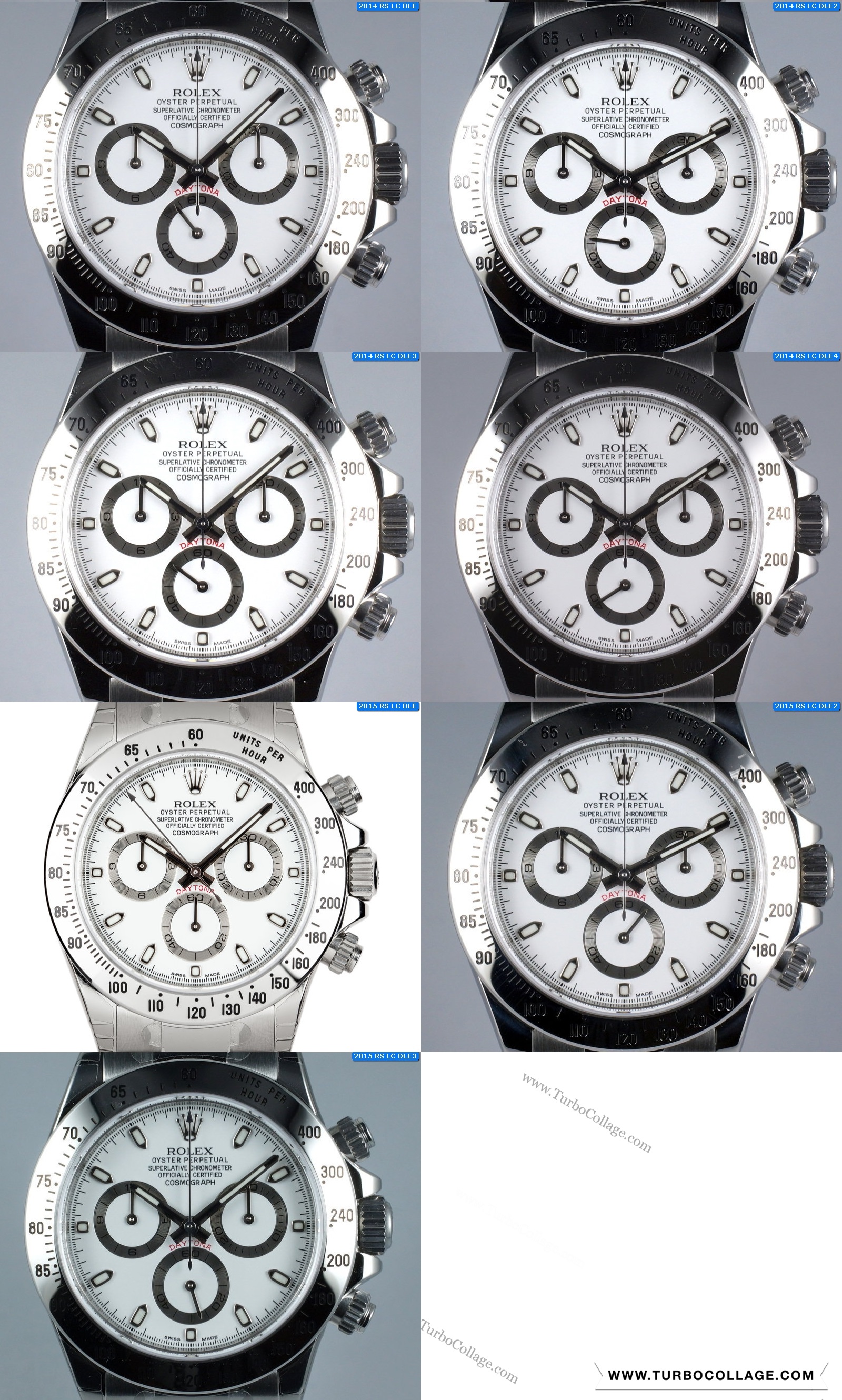

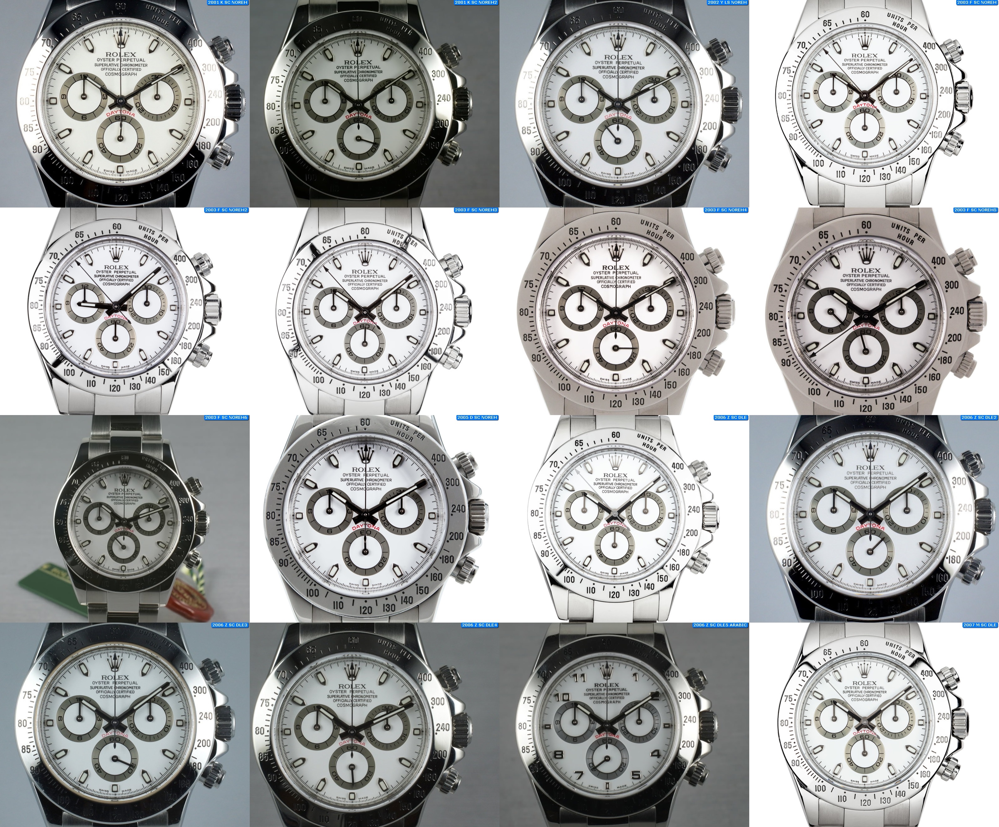

5.APH dials ~2009ish-2016 :
EDIT : ***
looking on chrono24 again, i've found the APH dial present on the daytona as early as 2006-2008 . But as i said , all info reagarding watches found on chrono should be taken with a grain of salt.
In order to narrow the results for this dial type i'll list below all APH dials found on chrono along their correspondig year :
2006 - 1 dial
2007 - 1 dial
2008 - 2 dials
2009 - 4 dials
2010 - 5 dials
2011 - 3 dials
2012 - 3 dials
2013 - 10 dials - only 1 other dial model were found for 2013
2014 - 7 dials - no other dial models were found for 2014
2015 - 15 dials - no other dial models were found for 2015
2016 - 3 dials
As you can see, this dial was mostly used on watches made between 2013-2016 but sadly this info is not enaugh to establish an exact watch manufacturing year .
The white APH dial is pretty much the same as the black APH dial, so same characteristics apply:
- 'O' in 'Oyster' looks like a zero this time
- More tracking on the OYSTER PERPETUAL / space between letters is bigger
- I won’t bother to list the remaining characteristics as these are not relevant imo.
Pic above split in 2 again :

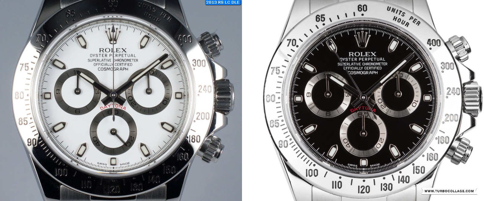

Comparison pic between the vlack and white APH dial :
Close-up of the APH layout :

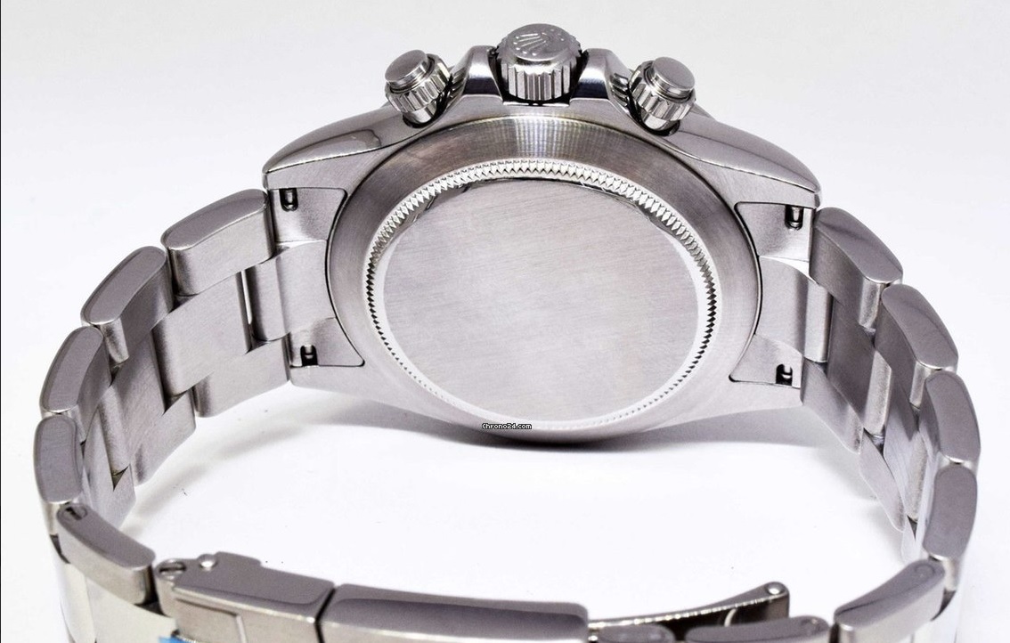

- EL (end link) is made out of 3 pieces clamped together
3 pieces END LINK :
Here is another picture that better shows the 3 pieces END LINK :

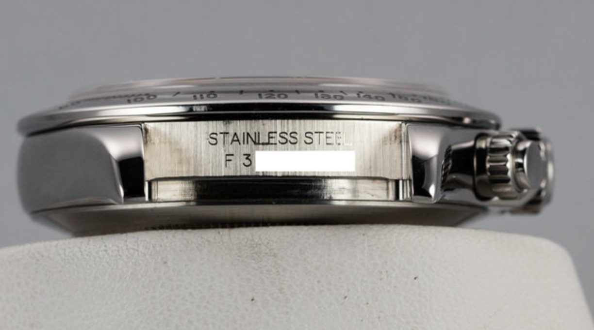

Please note that the cases which are not engraved on the rehaut, the serial will be engraved between the lugs as so :
Notice: There was another category in my previous attempt to classify the black dials, called the funny E. However, after a closer inspection, I’ve realised that the watch in discussion was most probably serviced with some pre-owned parts. The case itself was indeed a 2007 M but the dial was a flat4serif, hands were slim, like on the 2002 models and the insert was actually from an older generation 16520 daytona . So in conclusion, the funny E does no longer exist.
Here is the watch I was referring to :
Tag meaning is the same as for the black dials:
RS - Random serial
SC - short clasp / old style clasp
LC - long clasp / current style
DLE - double line engraving
NOREH - no rehaut engraving
EDIT : ***
2006 - 1 dial
2007 - 1 dial
2008 - 2 dials
2009 - 4 dials
2010 - 5 dials
2011 - 3 dials
2012 - 3 dials
2016 - 3 dials

Here is a 2015 laser etched rehaut :
