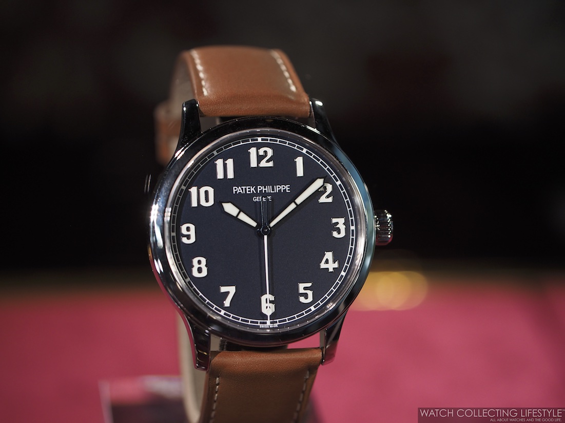

The 5524G is a watch which divides opinions. It’s not in line with the modern or typical classic design of what people associate to PP. Many were surprised that PP introduced a Pilot Watch. Though when looking at the history, Patek Philippe are not unfamiliar with pilot watches.
Patek Philippe have a long history of producing watches used by airforce pilots and officers watches from the world wars
This prototype pilot watch from 1936 was sold for 1.9 million USD in 2009 at Christie’s:
Even though there is a clear historical connection, many still felt that this watch was very un-Patek. But opinions have been changing lately, since its introduction in 2015, this watch has been gaining popularity.
Patek Philippe responded by introducing the limited edition 5522A in 2017, which was made entirely in steel:
Patek+Philippe+Calatrava+Pilot+Watch+ref.+5522+New+York+2017+Special+Edition+Live+Picture
The rosegold 5524R in 2018, and the 5520P in march 2019 which included an alarm function:
They also made a unique 5524T (1 piece only) in support for the Geneva based Children Action. In my opinion one of the most beautiful watches I’ve seen for a very long time.
Whether one likes it or not, this watch and the line of design has come to stay.
