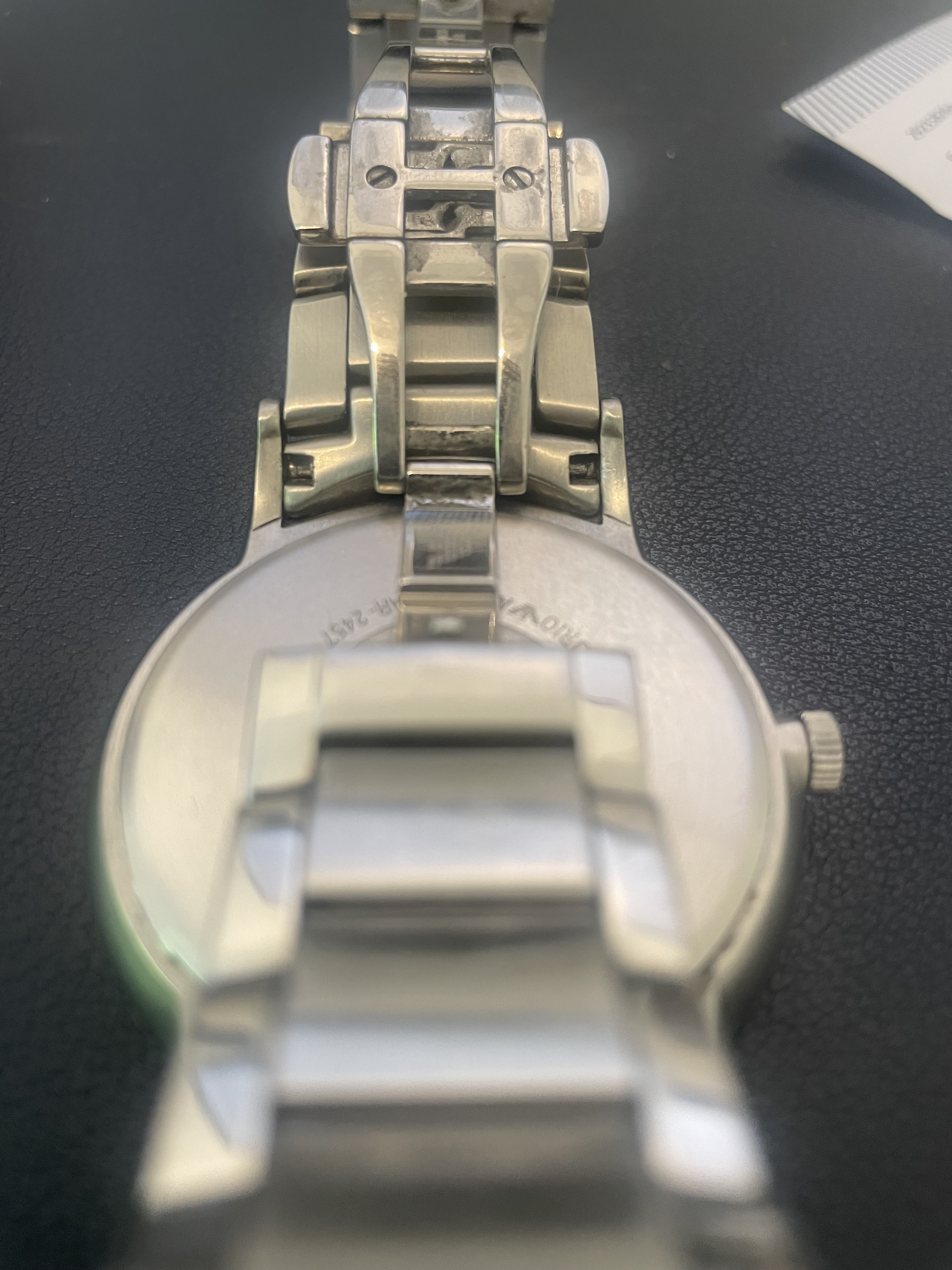

This might be a (very) stupid question, but I find removing the bracelet of my watch to be extremely difficult. The watch in question is a shitty Emporio Armani that I bought 9 or 10 years ago. What I don't seem to understand is, what is exactly the problem?

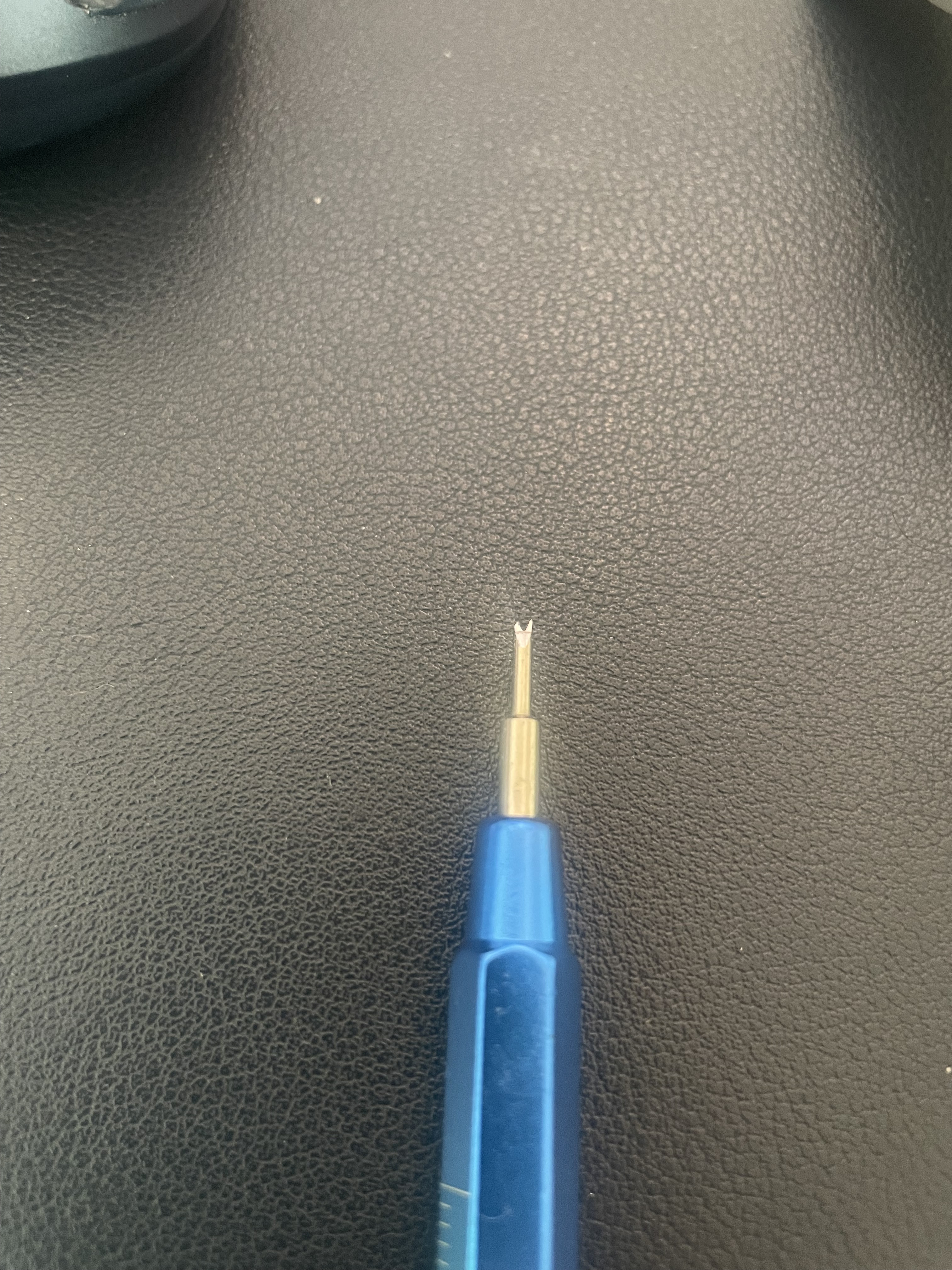

Could it be that the tools I'm using (cheap kit bought from Amazon for 17€, link here if anyone is interested to take a look) are just bad?
Or that the springs of my watch are just hard because it's old and never was maintained?
Or is it just me and I'm useless?

Hi, it could be any combination of the above - maybe some photos of the back of the watch/access to springbars and the tool you are trying to use would help, then we can advise from there?

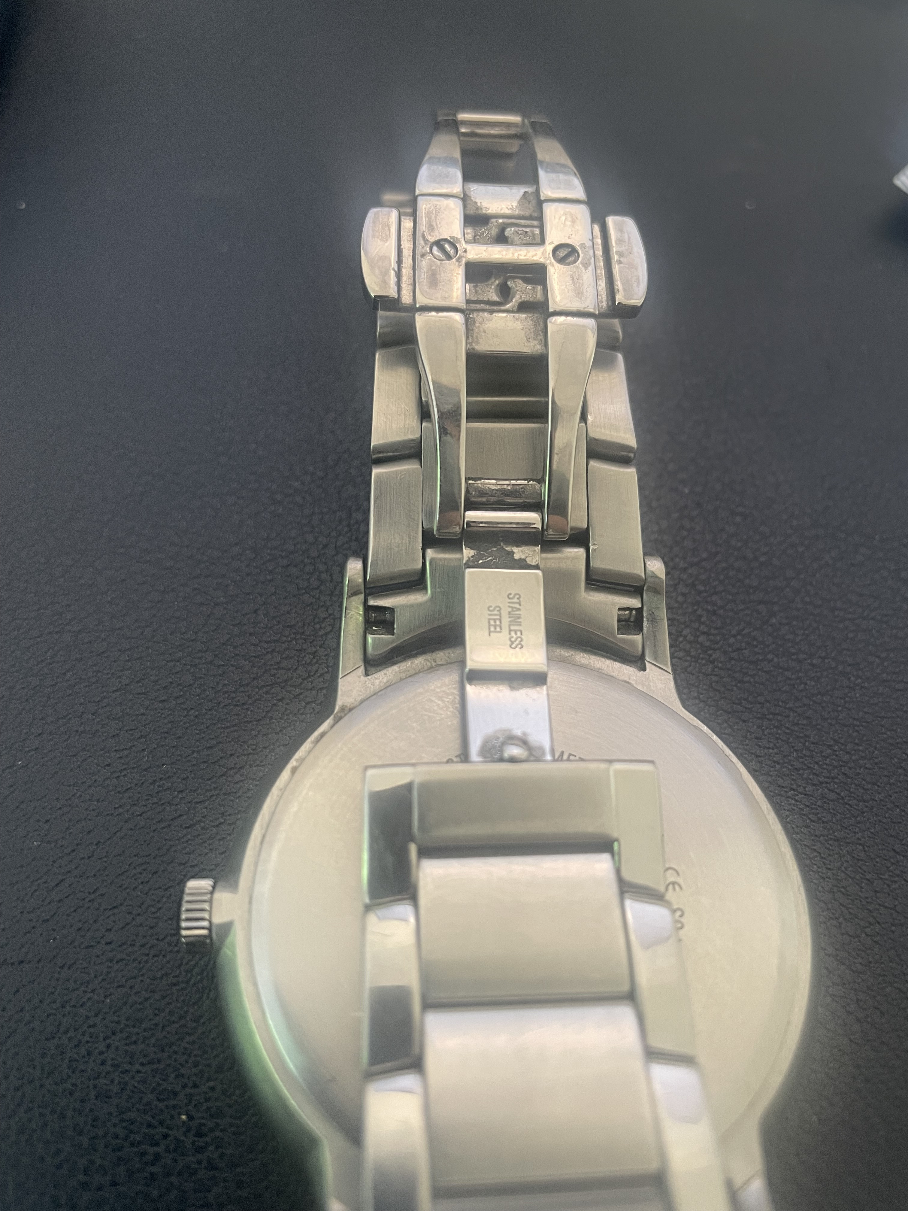

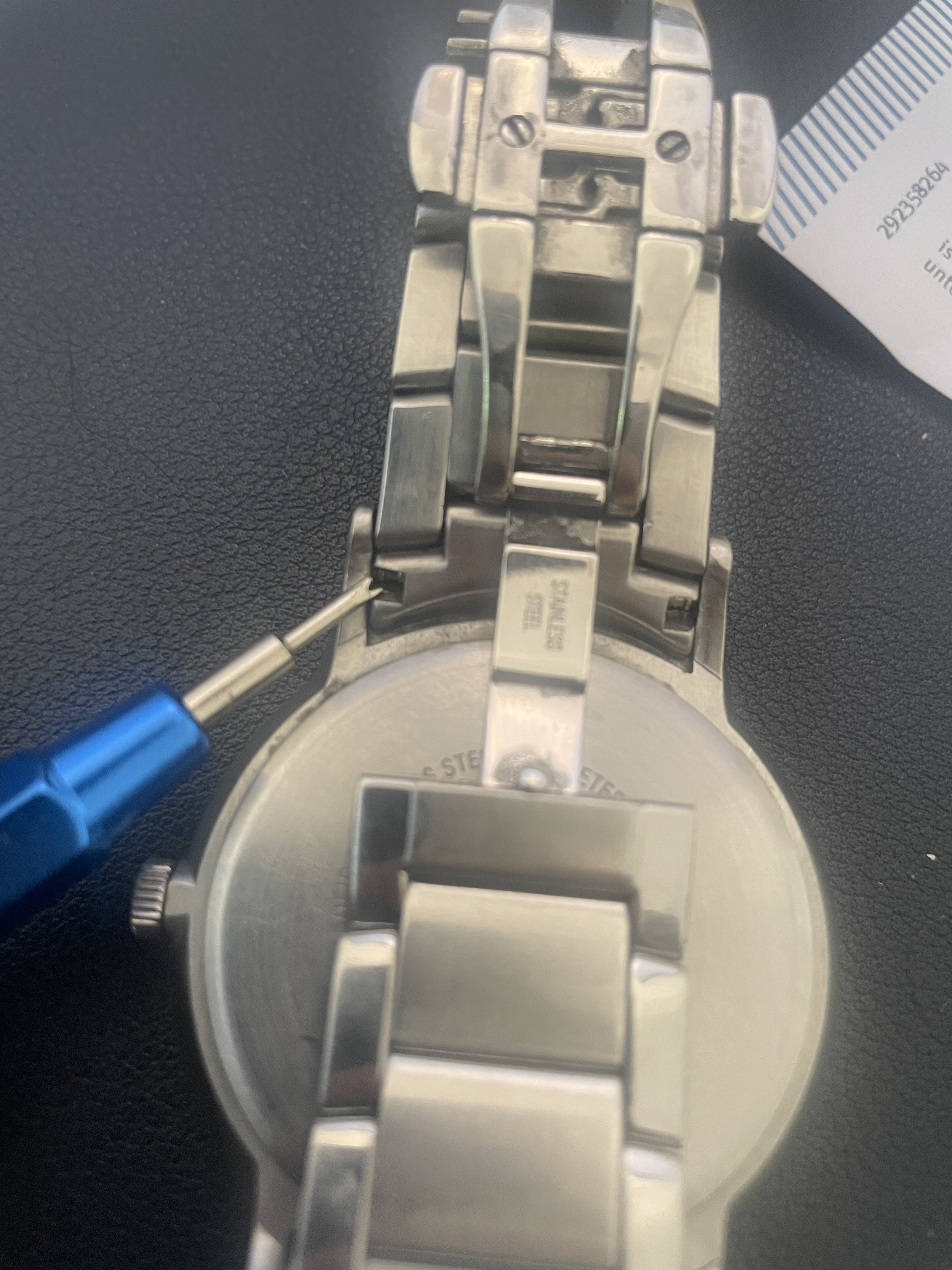

Sorry for the bad quality, is the best my phone can do.
In the pictures you can even see that the tool already started to break after attempting to open the watch a few times. I've tried with a gen Tag Heuer and is the same, I couldn't open it.

Your tool is cheap and not high quality. Invest in Bergeon Tweezers.
You can already see the tips of the metal is bent on your springbar tool. The quality is not great.

Okay that helps thank you - personally, I would say it's mostly down to the tool. I would recommend investing in a decent springbar tool, like a Bergeon 6767S - this is what I use and it does make a difference. Some prefer the tweezer style tools, which can make the job easier on some watches (I personally find these tools themselves a bit fiddly - as they require a little bit of adjustment to align the tips and get the spacing right to suit the bracelet you are working on. These versions can vary quite a bit in price for a good quality one, from around £20 for a "swiss style" tool from Cousins, up to approx £150 for a Bergeon 6825 tool.
I find that technique plays a big role here too when using a single ended tool - once you have one side of the springbar released from the lug hole, apply a bit of pressure to the end link from the front to keep the springbar from popping back into the hole, while using the tool to then release the other side is the trick. It's a bit fiddly if you've not done it successfully a few times, but easy once you know how and are confident with the tool that you're using.
The tweezer style are of course much easier to use and require a simple tweezer-action to nip both ends of the spring bar free of the lug, then simply push the end link away from the watch (ideally up towards you when looking at the case back to avoid the springbar potentially flying out and scratching the top of the lugs!)

Just to give a quick update, I got a Bergeon 7767-SF today and it was most definitely the tool.
I still need to get used to it, of course, but it was sooooo much easier.
That's great news! The right tool is definitely more than half of the battle, the remaining percentage being technique and experience, but they will come a lot quicker now you're armed with the right tool for the job!
