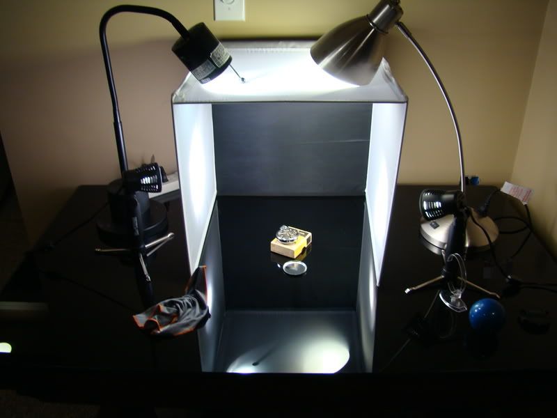

Go and get yourself a small light tent from walmart or ebay. My wife surprised me with my light tent that she bought from walmart. It came with 2 lights and a tripod.. Oh yeah... You MUST have a tripod. Just get yourself a little one that can sit on the table. They are 4-6 inches tall.
People will tell you that you dont have to buy a light tent.. that is true, I just found it a lot easier.. that's all..

Here is my setup.. It's pretty simple,, a couple lamps that I purchased on clearance from Office Depot.
lightbox.jpg~original

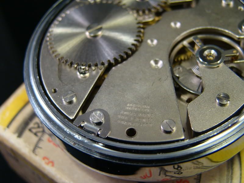

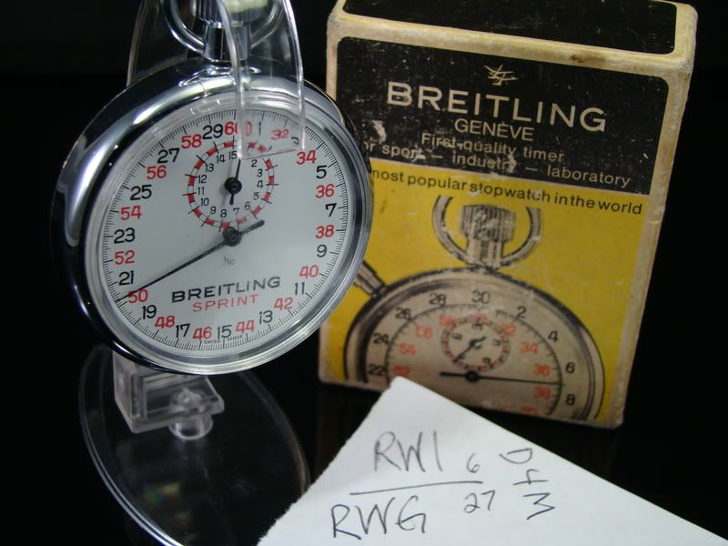

I was taking photo's of this:
sprint6.jpg~original
sprint9.jpg~original
