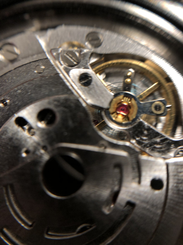

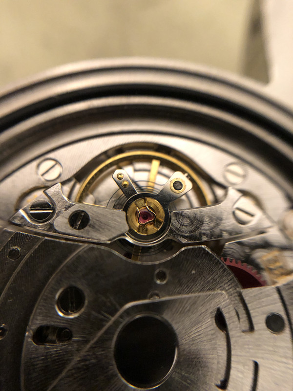

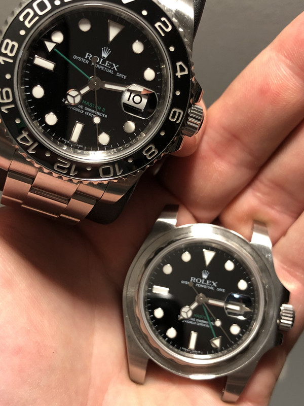

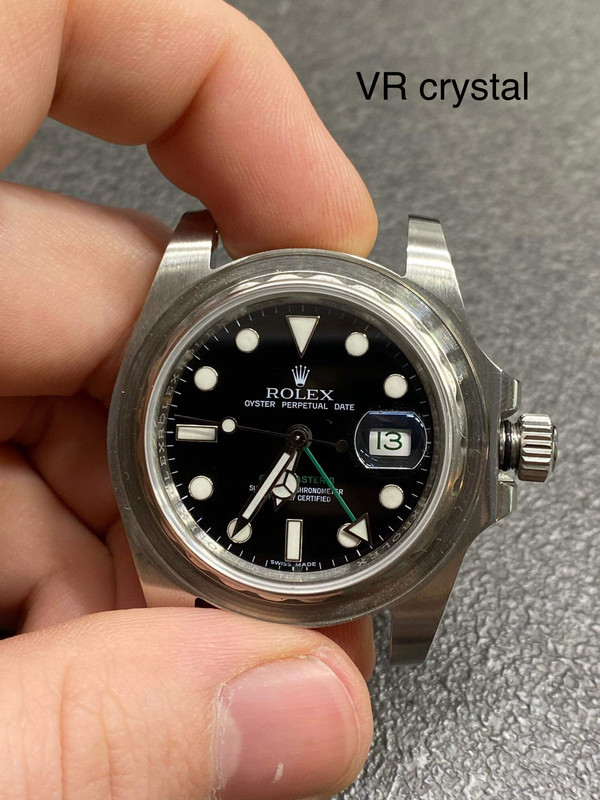

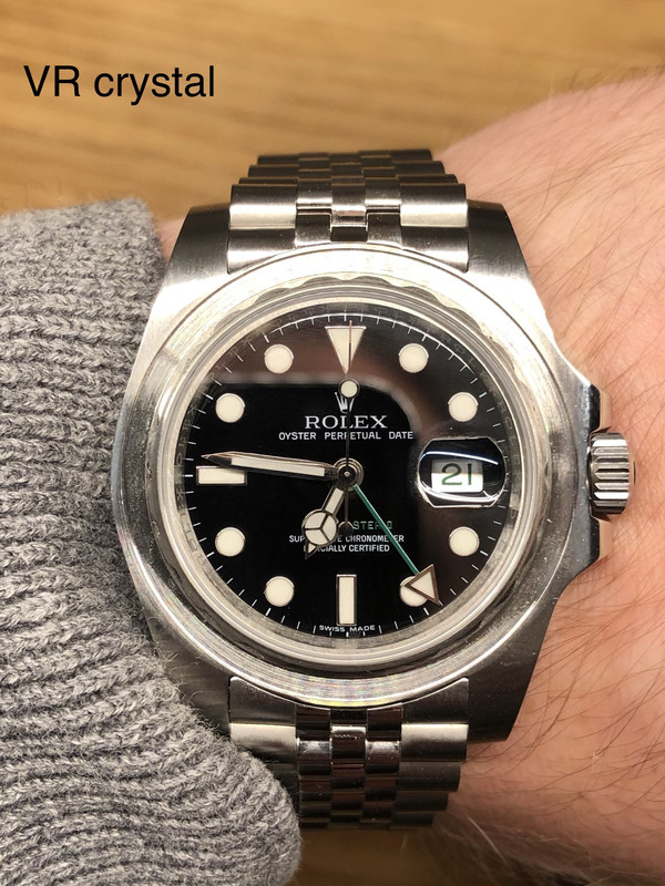

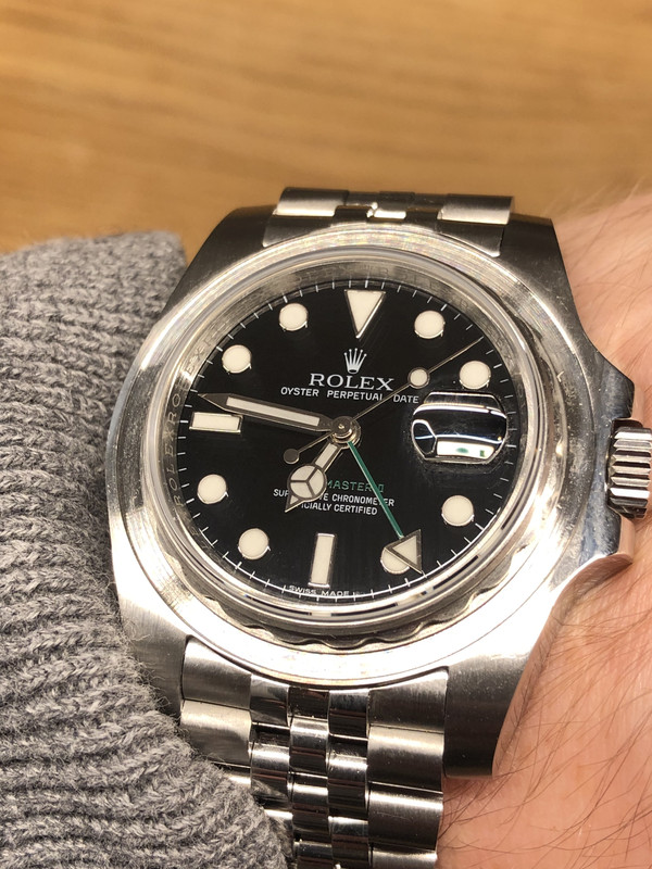

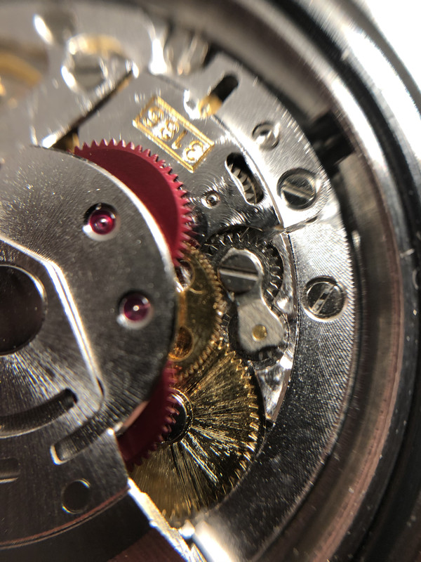

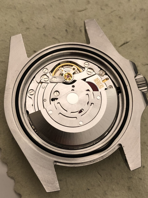

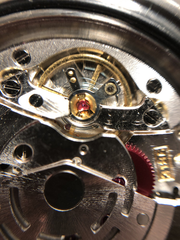

My god that is a beauty. Great work. I wish I had time. I have all the parts I just need to service my 3185. I got the 660 part its just been hell in my life the last few months. I will be home for a few days straight. Maybe I will finish the watch.

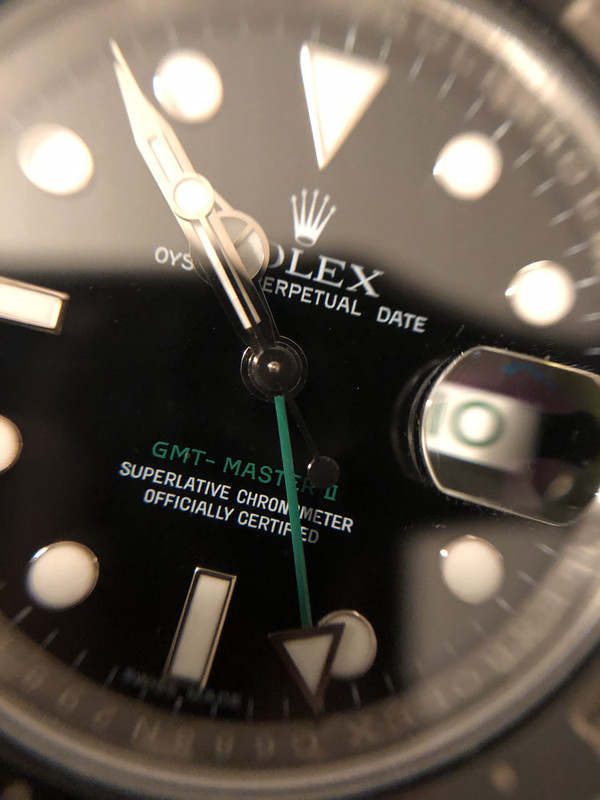

I have the same issue with the GMT hand. Truth though I would leave it right now till the movement starts acting up or until you have to do anything movement related. That crystal is amazing but it will show every mark, dust.
Great work! Love a great build. This here is what this hobby is all about!!!!!!

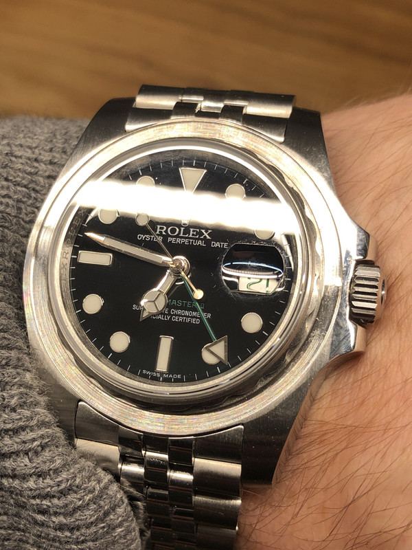

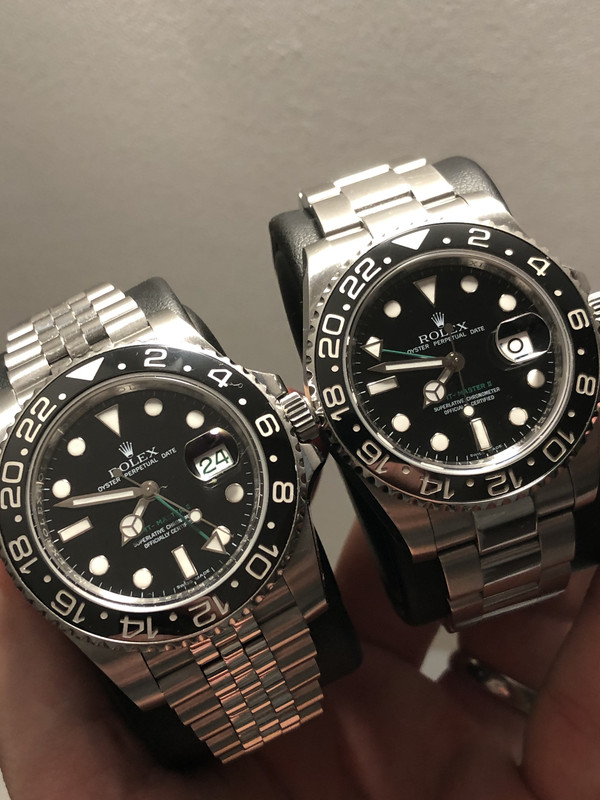

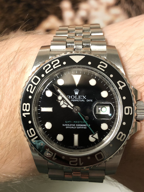

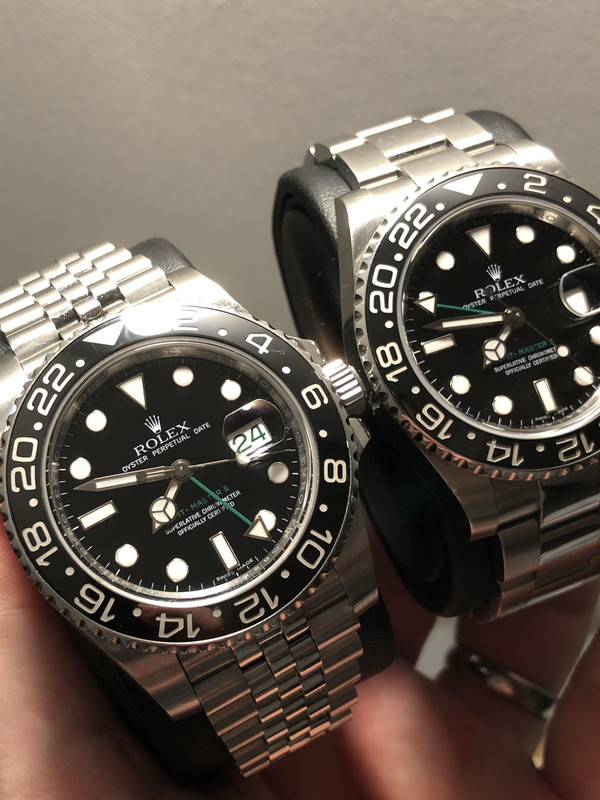

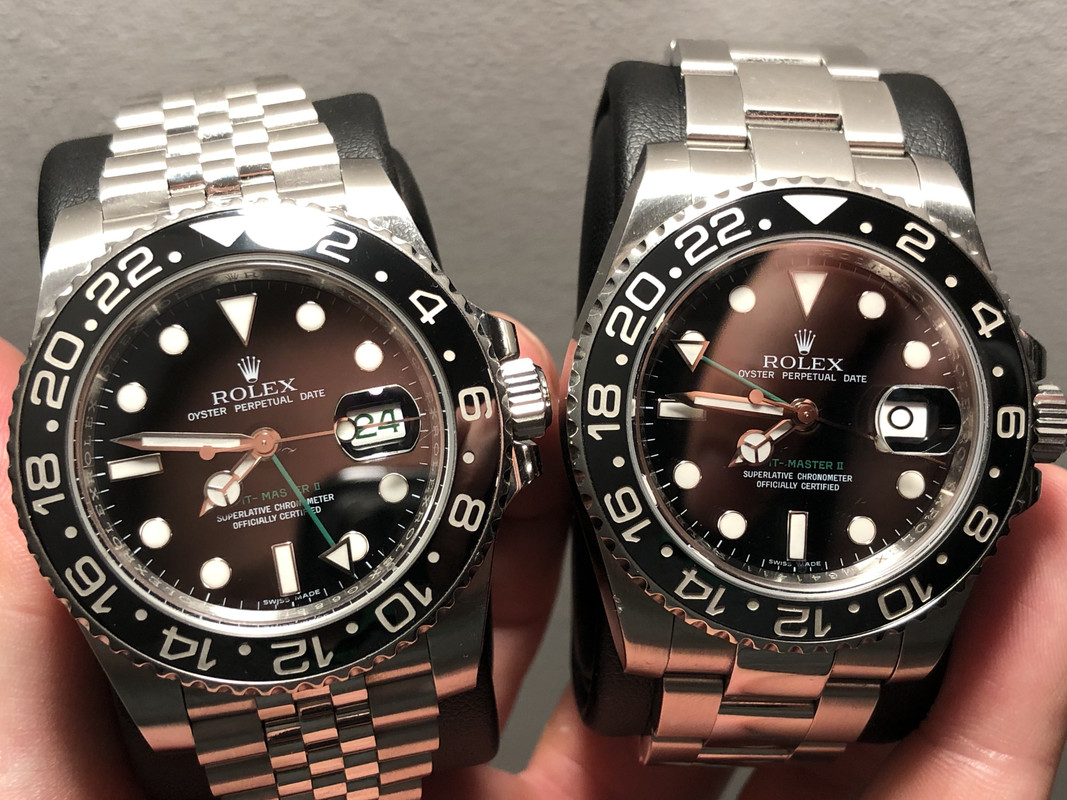

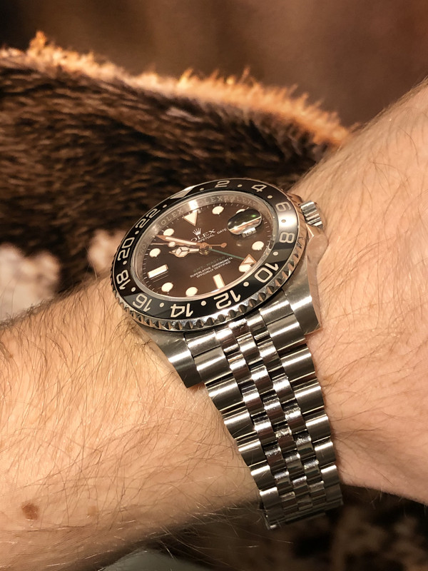

Lovely watch! I like the whole package and the green date is the cherry on top! Wear in good health, her little sister says hi! ;)
(this is a fantasy watch because I cannot stand the GMF BLRO insert, and I surprisingly found out that the LN insert and bezel were very affordable!
Beautiful build - my understanding is that for GMF the gen bezel just fits right on - no need to get gen clicking spring and etc?

Thanks Rob. Can’t wait to see yours.
Yeah I thought the same about the GMT hand. Will collect some further movement parts like the 660 and one day it will be replaced and fixed :)

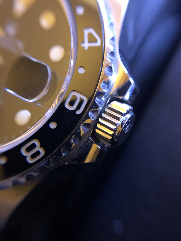

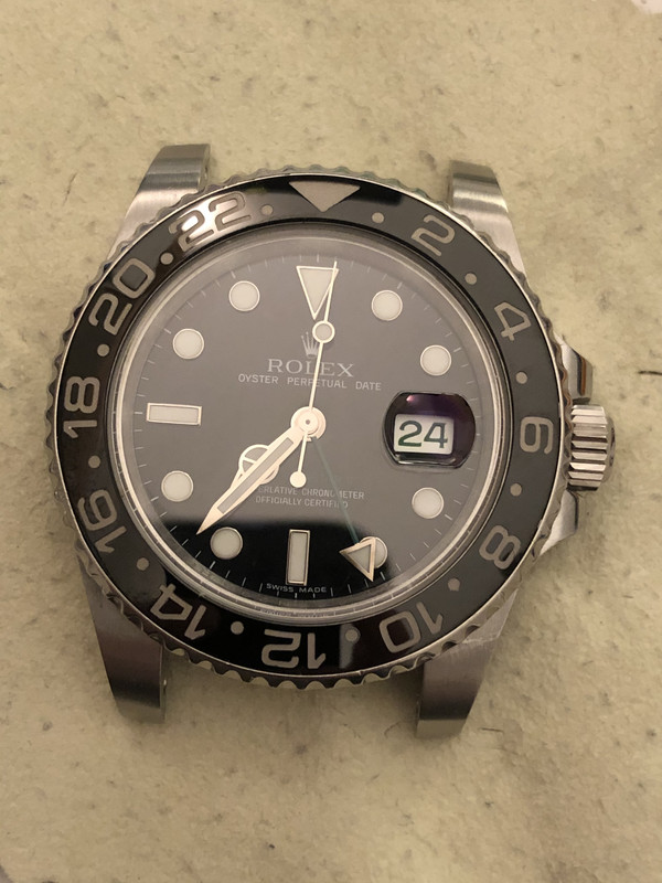

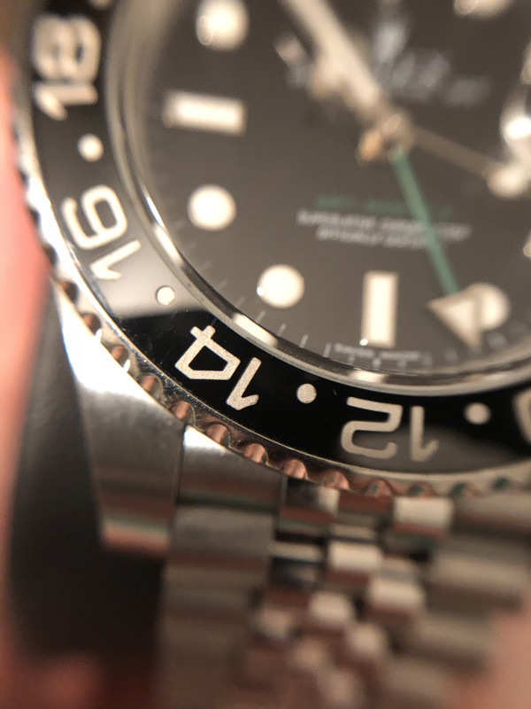

The gen bezel couldn't fit right in, I had to file down a little bit of the GMF hytrel joint

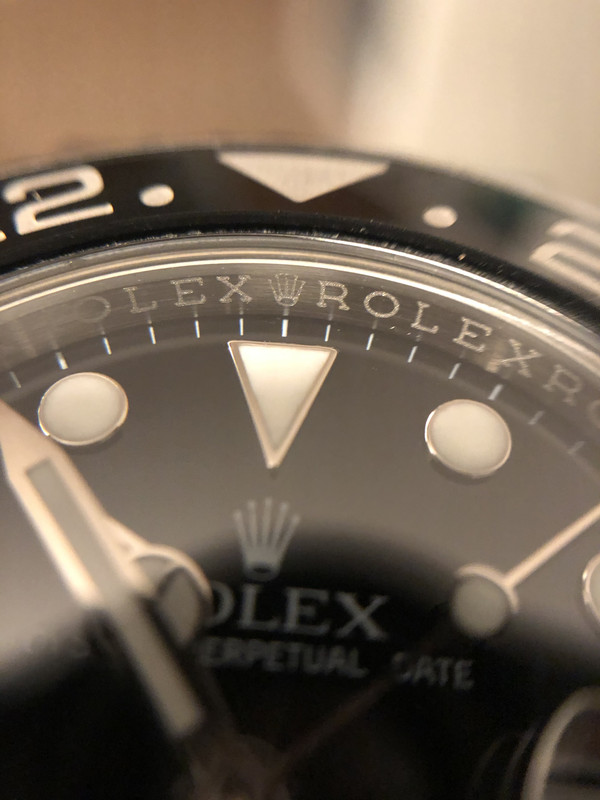

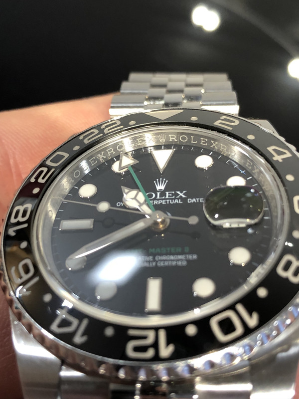

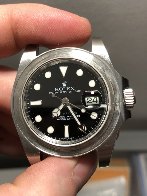

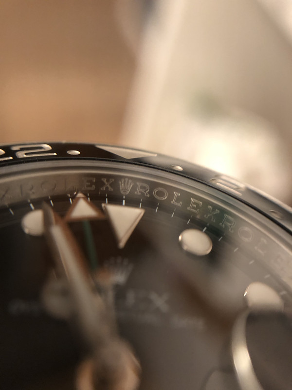

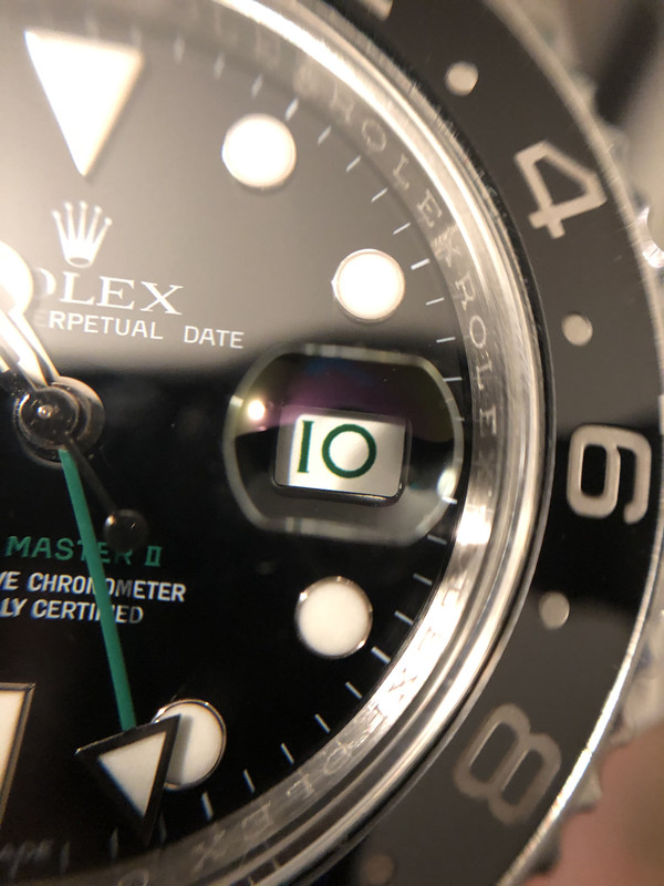

This is going to be another great one bro. I'd like to suggest you have your watchmaker/modder sand, polish and rebrush the top ledge of the rehaut while your watch is all apart. It's a 20-30 minute job and should not be left undone! Shame on VRF for this flaw.
Thanks KJ2020, I asked him and I'm very much looking forward to the end result. The 3185-660 module should arrive today ! I will share pictures when built

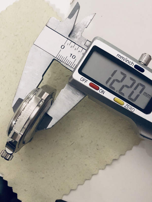

I think that is the spacer. I used the ARF crystal ring and not a real one. I have to measure the differences.
With my luck I just had my Gallbladder removed yesterday so haven’t slept yet from pain and sitting in my work shop chair will hurt to much. But I am home for the week so when I am feeling better I will measure the real and the Vrf and arf spacer. The Vrf crystal ring I destroyed but I have 2 new sealed up Rolex ones and the arf one on the bench. I will like to measure that also because I didn’t use the spacer on my build to fit the ARF bezel on the Vrf case.

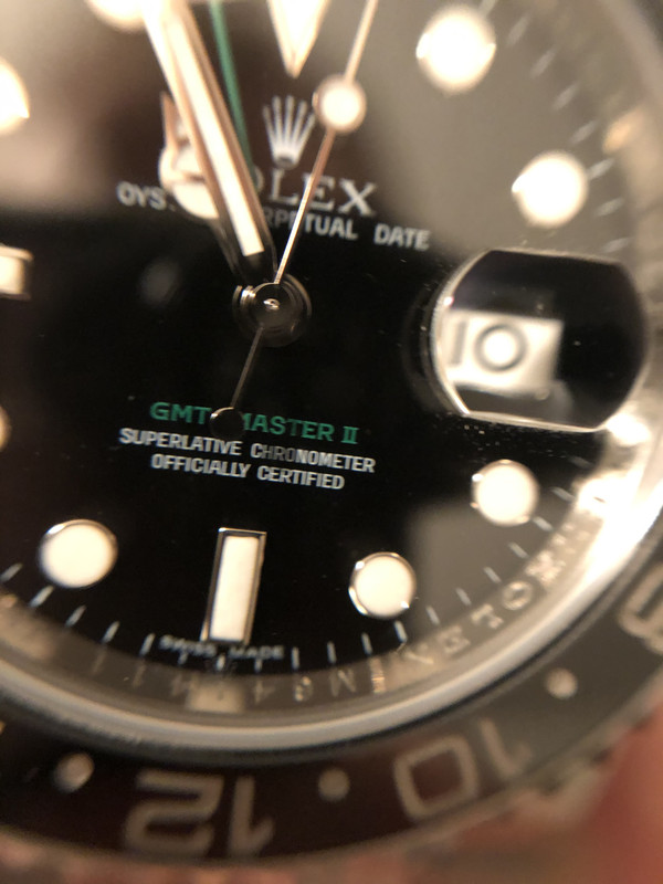

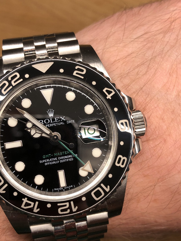

mega12 thanks for this review. That jubilee is a nice touch! I especially like the green datedisc. Would you (or anyone else here?) happen to have the part number for that? Can't find one anywhere. Thanks in advance.
Reactions: mega12
mega12
17/10/17
2,529
965
Thanks. I don’t remember the exact part number. Need to search. Maybe I will find
I imagine it is rare to some degree so that's why I'm not finding it... hoping the part number will help in my searches. Everytime I see one, I am green with envy... :cowboy:
If you don't have it readily available, I'll keep searching myself. Of course I will stilll appreciate it if you happen to find it and post it!

I found the part number of my red one.
I think green will be somehow similar
Time doesn’t exist, clocks exist.
mega12
17/10/17
2,529
965
Regular black has 16200
Red has 16205
Red/Black has 16206
So green should be somewhere around :)

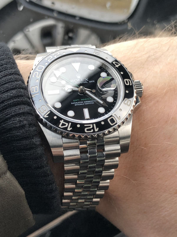

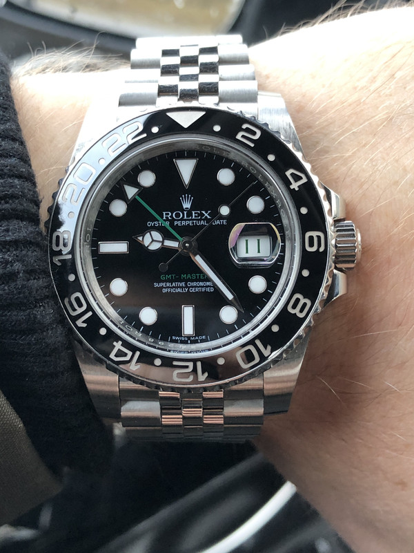

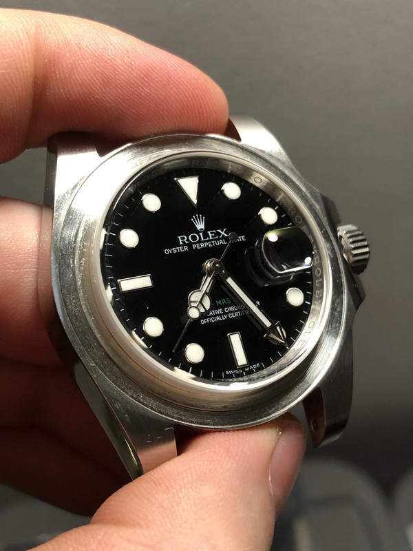

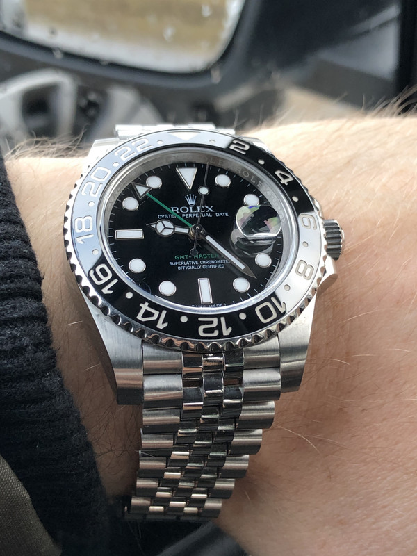

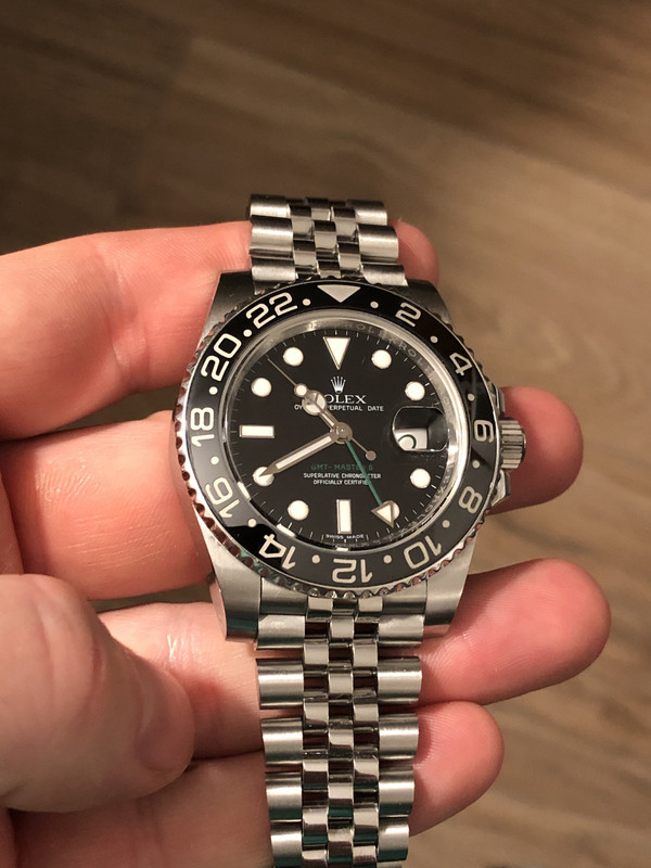

Got my watch back and the result is stunning ! However the rehaut is slightly misaligned to the left but it's still within Rolex tolerance.
Specs:
VRF 116710
VR3185 with a GEN module for jumping hours (3185-660)
GEN datewheel
GEN dial
GEN xtal
GEN ceramic insert, bezel, trigonal springs and tension ring
Reactions: Nivka and mega12

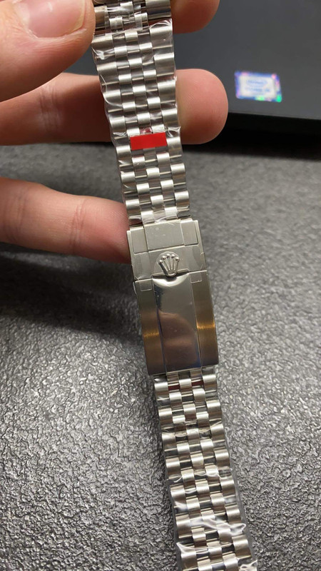

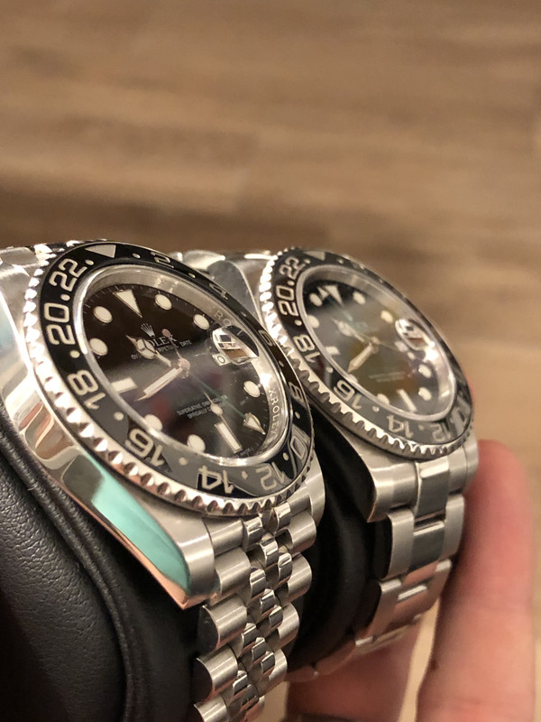

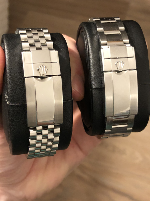

how is the VRF bracelet?

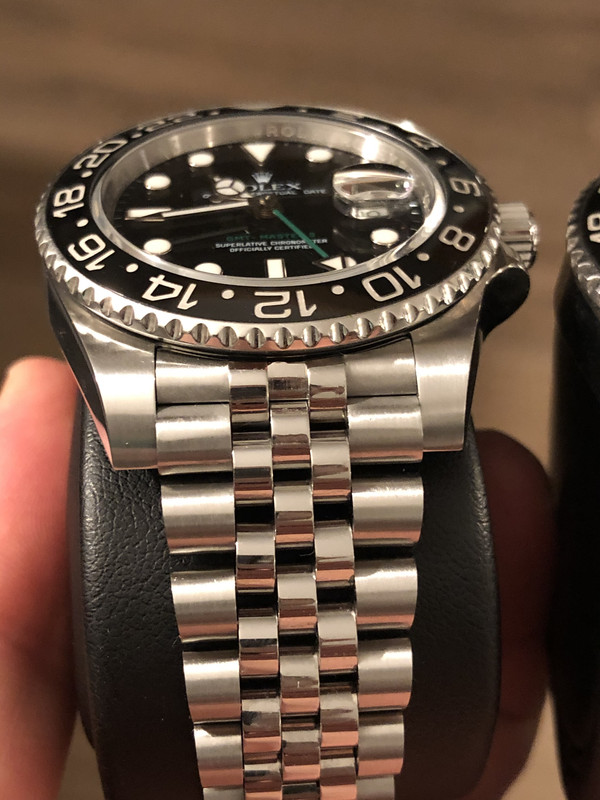

Beautiful watch!
How did you mount the bezel? Gen retaining / crystal ring or VRF? Because VRF doesn’t fit the gen bezel, what I had in mind.
Btw: my gen GMT has slightly misaligned rehaut as well ;)
jcher
1/8/17
1,836
678
Beautiful watch!
My watchsmith said he struggled a little indeed, but it worked as he used a gen retaining ring, gen trigonal springs and a gen spec bezel gasket ;-)
